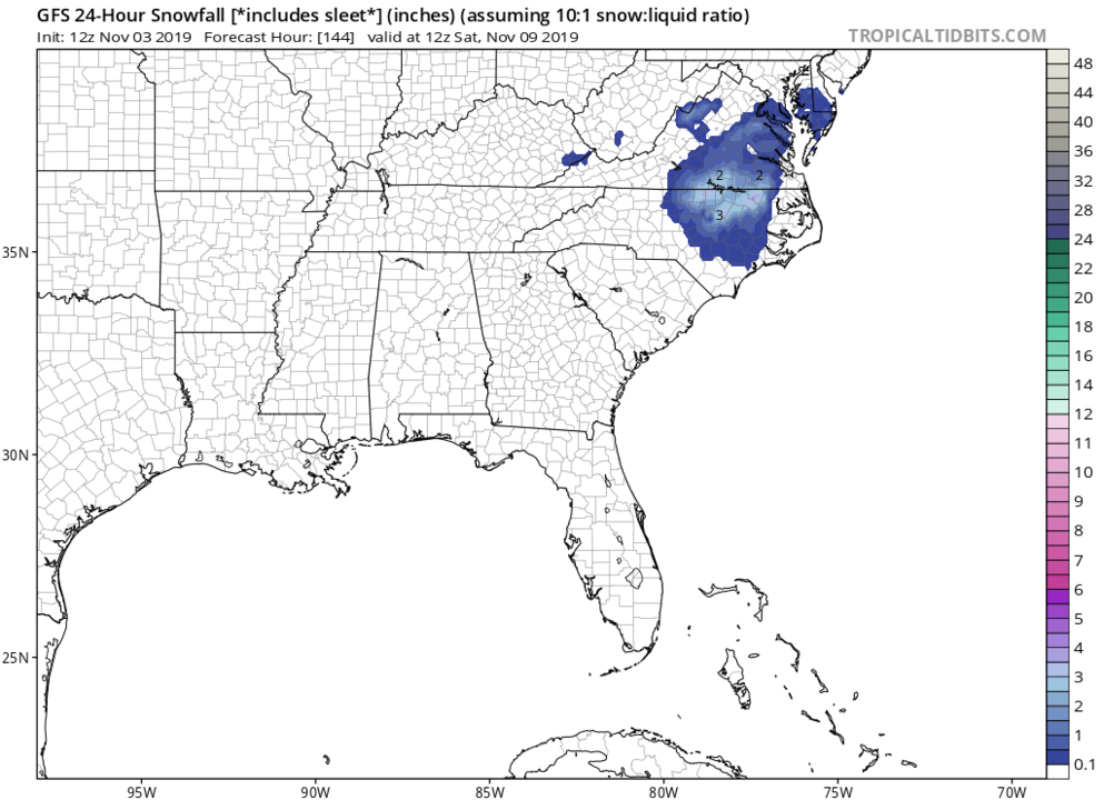

I just can not help myself.:embarrassed: The first weather maps that make sense for the Thursday-Friday timeframe.

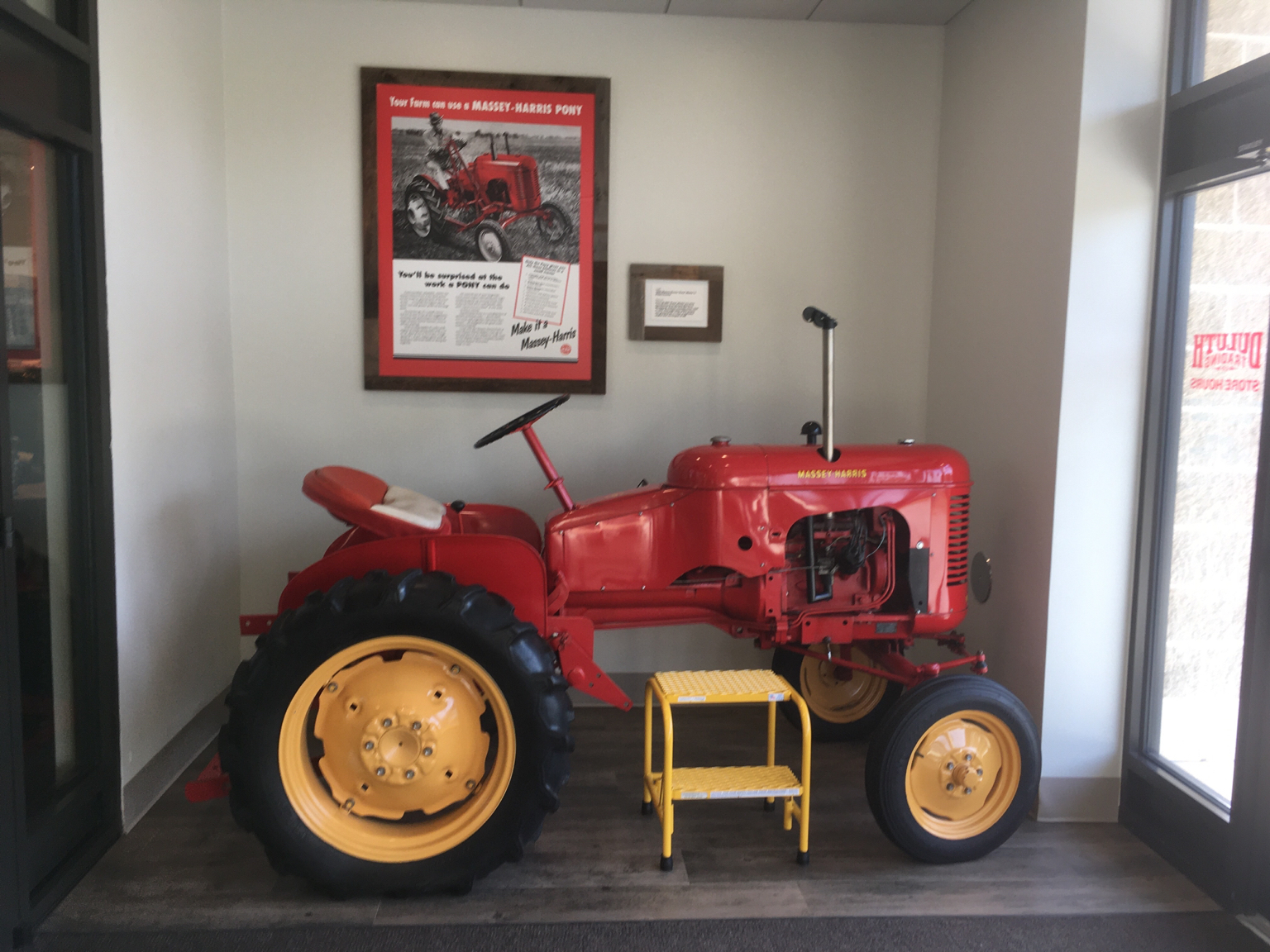

New store opened up this Fall down the road on IH35.
This was in the foyer. My kind of store.
