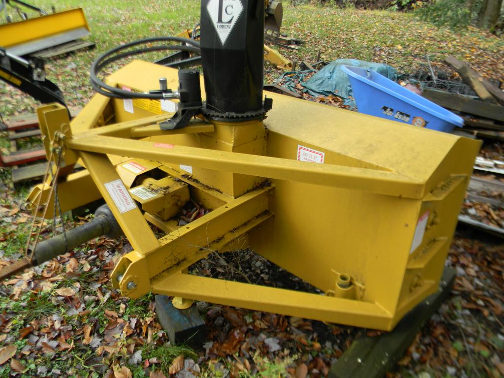

Found a Lorenz 730 that is used very little and looks like new with hydraulic chute rotation for 1/2 of new price I am going to jump on and will see what I can come up with from there. Just need to drive to a neighboring state to get it.
Update, check just went into the mail for the Lorenz 730 so it is going to have to work on the Bobcat lol.
/ Good match or not "Snowblower"?
#9
Here is my new snow moving tool. Now to drive 400 miles to go pick it up next week. Got it for $3150 plus the states cut since Minnesota taxes snowblowers. :thumbsdown: Checked a few local dealers and price for new ones are 5900 for the 730 with hyd rotation.

I was going to suggest a couple of sprockets, a chain, and a jackshaft arrangement to raise the PTO shaft. Looking at the picture that would be difficult on that
blower
/ Good match or not "Snowblower"? #11
Congrats on the 730. I bought the same model (used) last Feb. I had to weld on some steel and drill new hole for the top link to fit my HF quick hitch. I think you'll be fine with your 23" high PTO shaft. Mine is 21" and the blower works fine.
