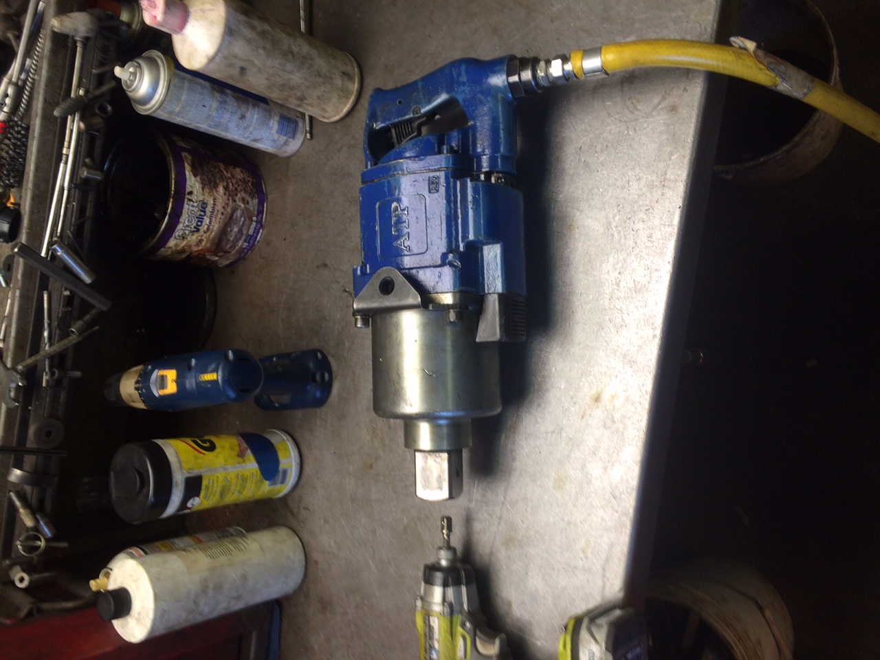

ATP 1550 1.5"drive, 3000 ft pounds torque. :thumbsup:

The 1.5" impact I showed, really should have a .75" air hose.
You can "get away" with the smaller hose, if it's reasonably short, by using higher pressure.
The pressure helps make up for the lack of volume. The huge draw from the tool, causes the pressure to drop significantly in the hose, getting it near the rated pressure.
I have tested 1" and 1.5" impacts on a Skidmore torque tester, and they do well that way.
A 3/4" impact can work fine on a 3/8 hose, using the same principal.
If you are one of those guys that uses full line pressure all the time, (I do), this really doesn't help you.
