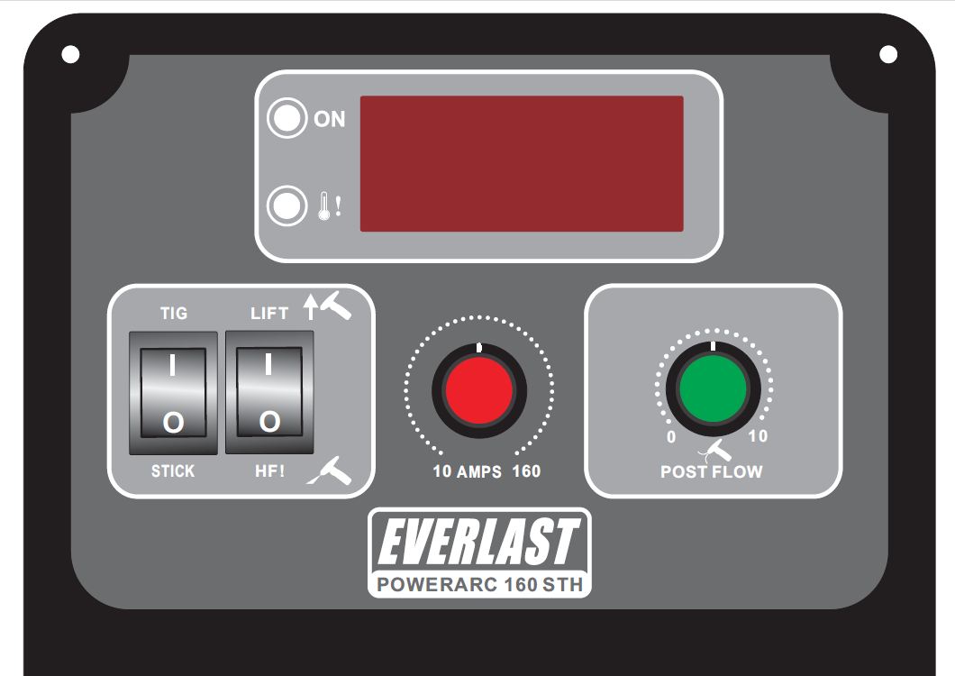

Here's the deal with the new 160...
We are updating the site. All the information isn't up yet. The new unit won't perform as well on 6010, but is similar to the 140, but with a built in solenoid and an option of DC HF or lift start . It's sort of favoring TIG in lieu of the 6010. It also is slated to have a foot pedal capability when it comes to the US. The current ones we have are being drop shipped from Canada. They are an early version of what we will have, and are not dual voltage yet.
The 140 will pull 29 amps on 220V, 240V will be lower closer to 25 amps or so. Out put will depend upon exact voltage, but it will also will be limited to breaker size. I have welded quite respectably with 1/8" rods. The 160 will be a little bit better though. I am waiting on final details and results of the dual voltage testing before making too big of a commitment on performance.
   / Good homeowner welder? #47
Mark please keep us updated on this new 160, and you say it can have a gas solenoid and HF start and a foot pedal as an option? I would be interested in hearing more about it. Let us know when testing is complete .
James K0UA
   / Good homeowner welder? #48
My future son-in-law who welds for a living but manages to keep it simple for my simple mind says: "DC leaves less slag" :thumbsup:. To me that means less work to clean up my great welds!! :ashamed:
RC
   / Good homeowner welder? #49
James K0UA
James,
It will have the HF start as a standard. But it will also offer a switch to choose between lift start and HF. It will have a simple 0-160 amp pedal, that offers full range of control while in Tig mode and it will be optional. Expect about 50-75.00 extra add in if bought with unit. No, you can't limit amps on the panel, but with only 160 amps, it isn't bad to manage your average DC weld of 70-120 amps.
I have the final panel design I created, and confirmed with the factory this week...and am posting here for all to see for the first time. This unit should be in in a month or a little longer. The whole month of February is being taken up by Everlast production alone, and none of its other world wide customers will be in production.
I'll have a final production picture soon.
