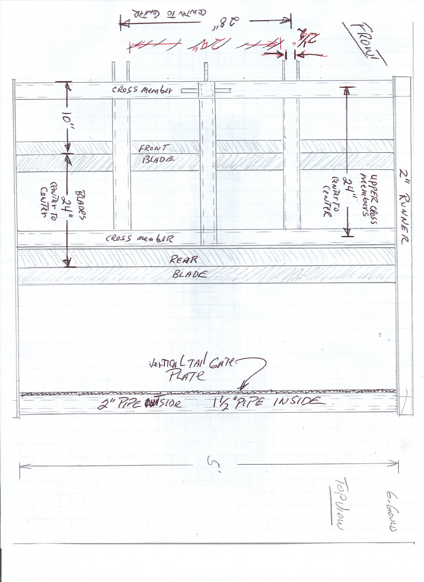

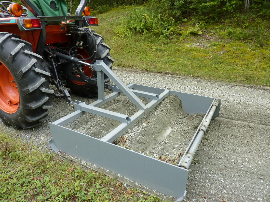

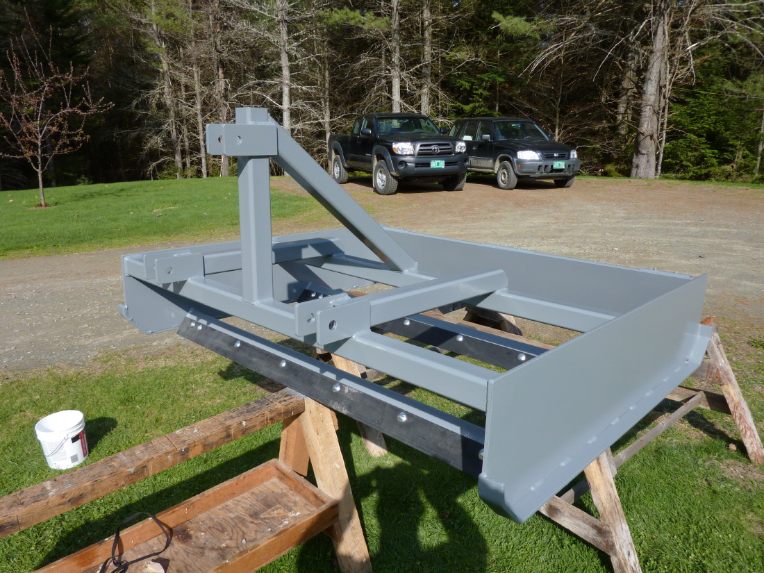

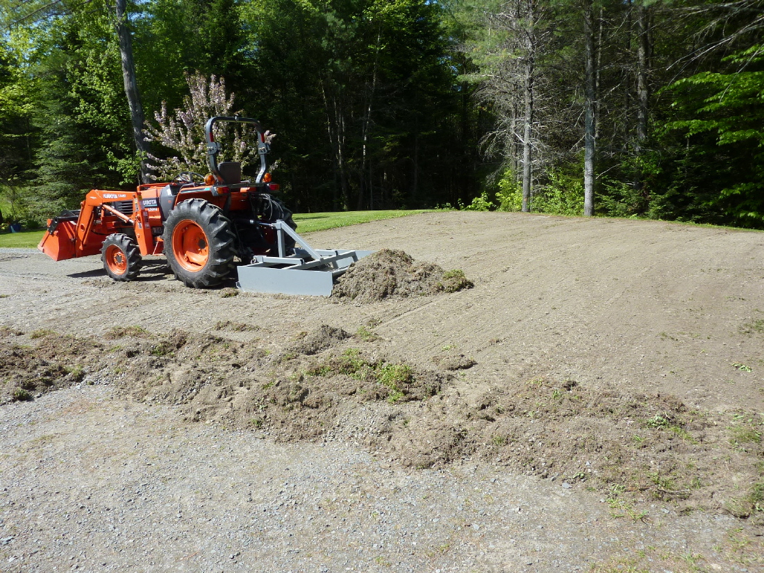

This is what works well for me on my 10 to 12 foot wide gravel road. 30 HP tractor and a 6 foot rear blade to set the drainage contours. But I use it very seldom now.
I don't use the rear blade much because once the road contours are properly set I can keep them maintained with the LPGS. Mine is homemade and 5 foot wide. There are lots of them available.

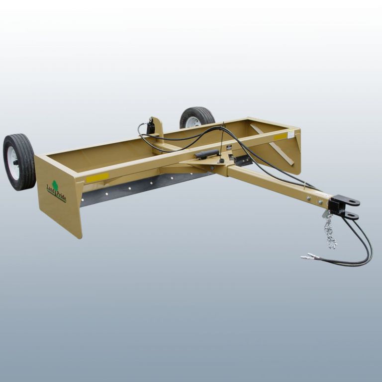

The one I like the best is a tow behind wheeled scraper. It stays level no matter what the tractor does. Having it's own wheels keeps it laser level even when the tractor is hitting dips going up and down. bb45_main.jpg

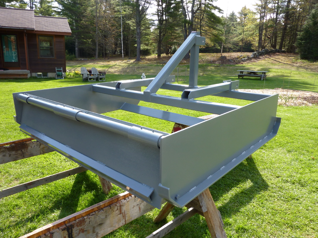

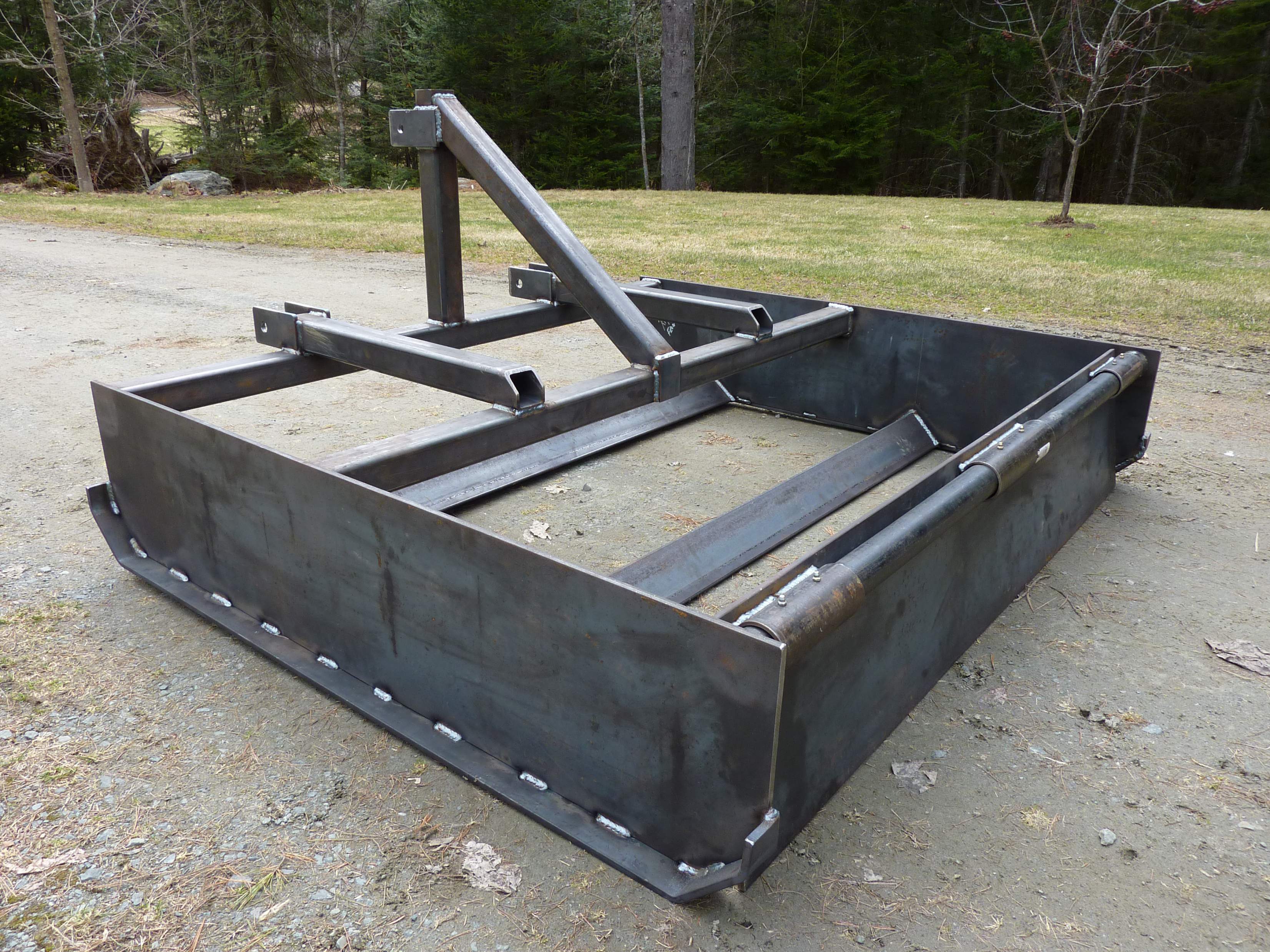

Very Nice LPGS Gordon!!!!! Did you post a thread with pictures of this build??? Or if not would you consider it?? I especially like the way you built the rear gate!!!! I'm guessing it can be opened to let material flow thru?? Any details would be great!!!
   / good gravel lane leveling attachment #10
There is a set of stop pins the bottom of the gate hits against. The rear gate has three positions. I can have it up out of the way so material has clear passage. I can hang the gate behind the stops so it acts like a free drag but traps light material like sod. It also acts as a push blade in reverse. This is very useful.
Or I can hang the gate in front of the stops so I can collect material in the box and move it along the road like a box blade. I control the distribution with the hydraulic top link.

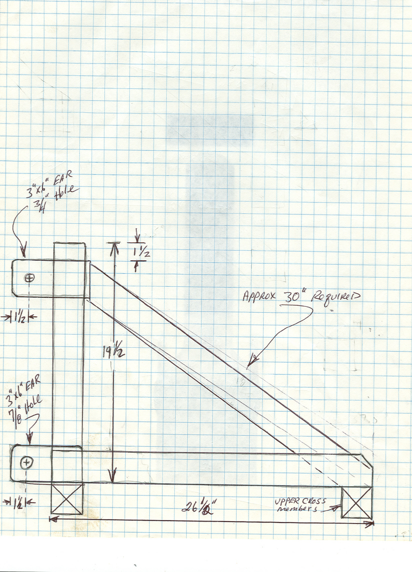

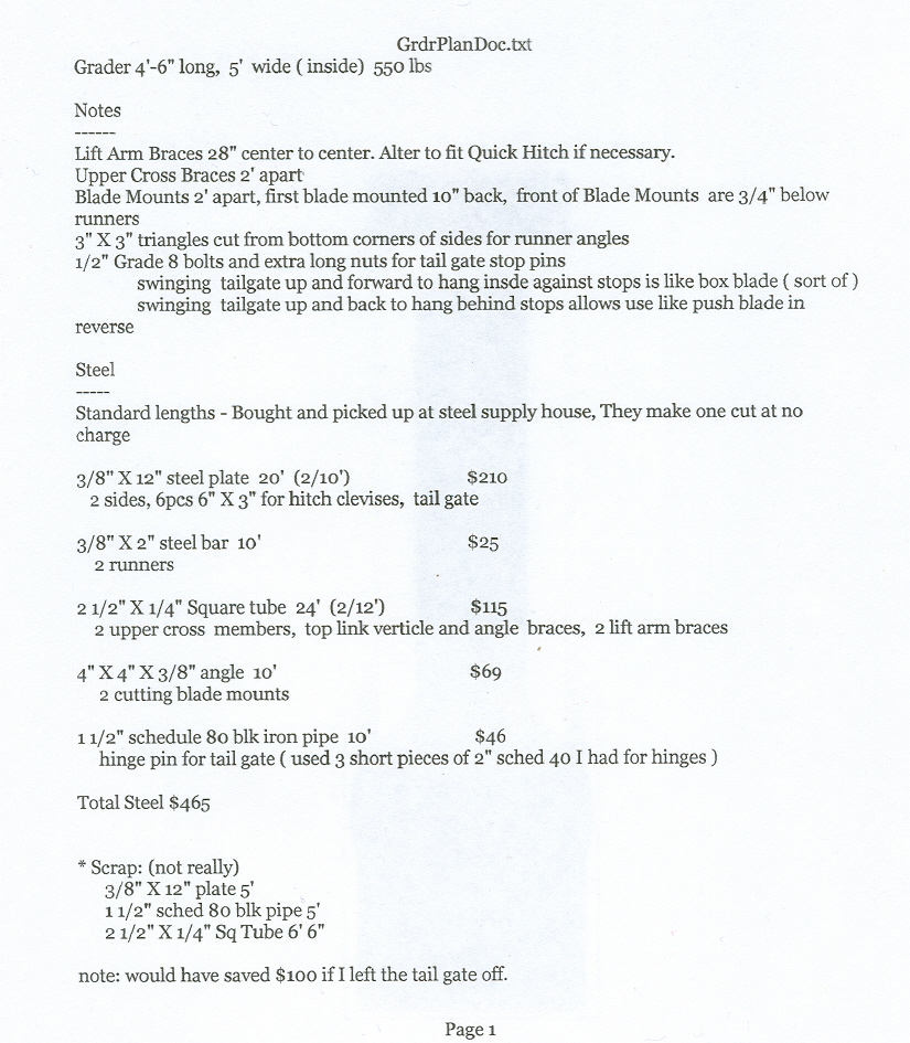

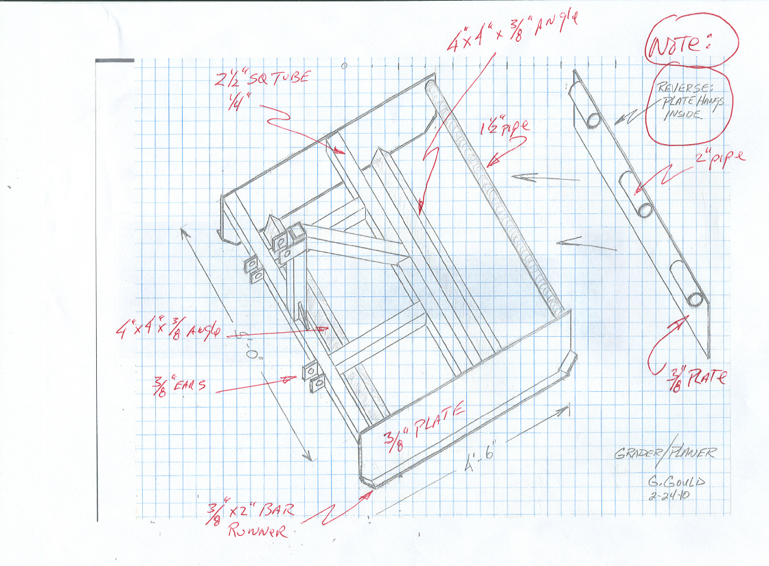

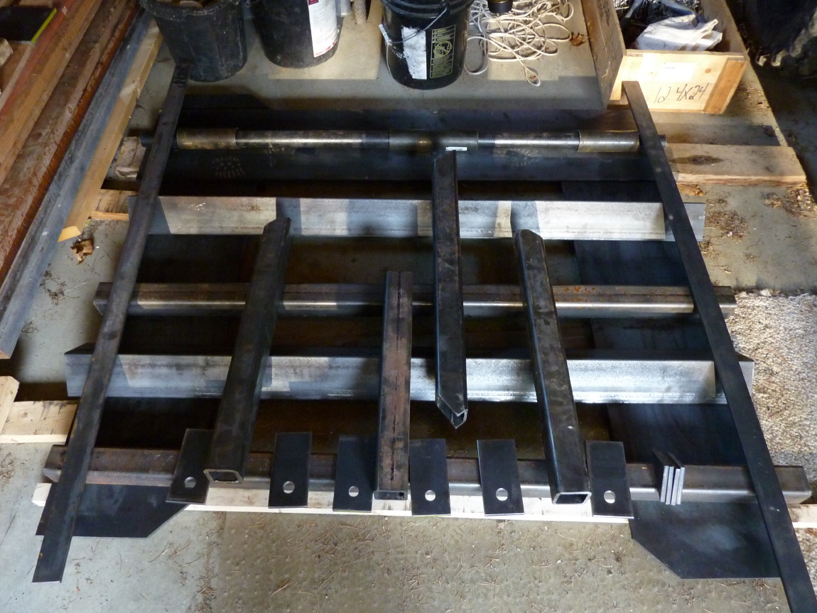

Here are my plans. I would look at others on here too. There are lots of good ones Look especially Jenkinsph (Steve's). He has some nice heavy builds. You need it to be heavy. Mine is 5' wide and 550 lbs plus the cutting edges - could be heavier.
Here are all the pieces after I cut them - ready to weld.
Basic plan. Note I did the lift arm attactments different from plan.

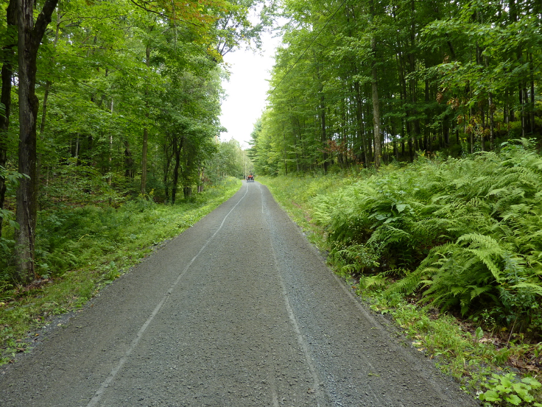

Side view
Top view
Finished job
