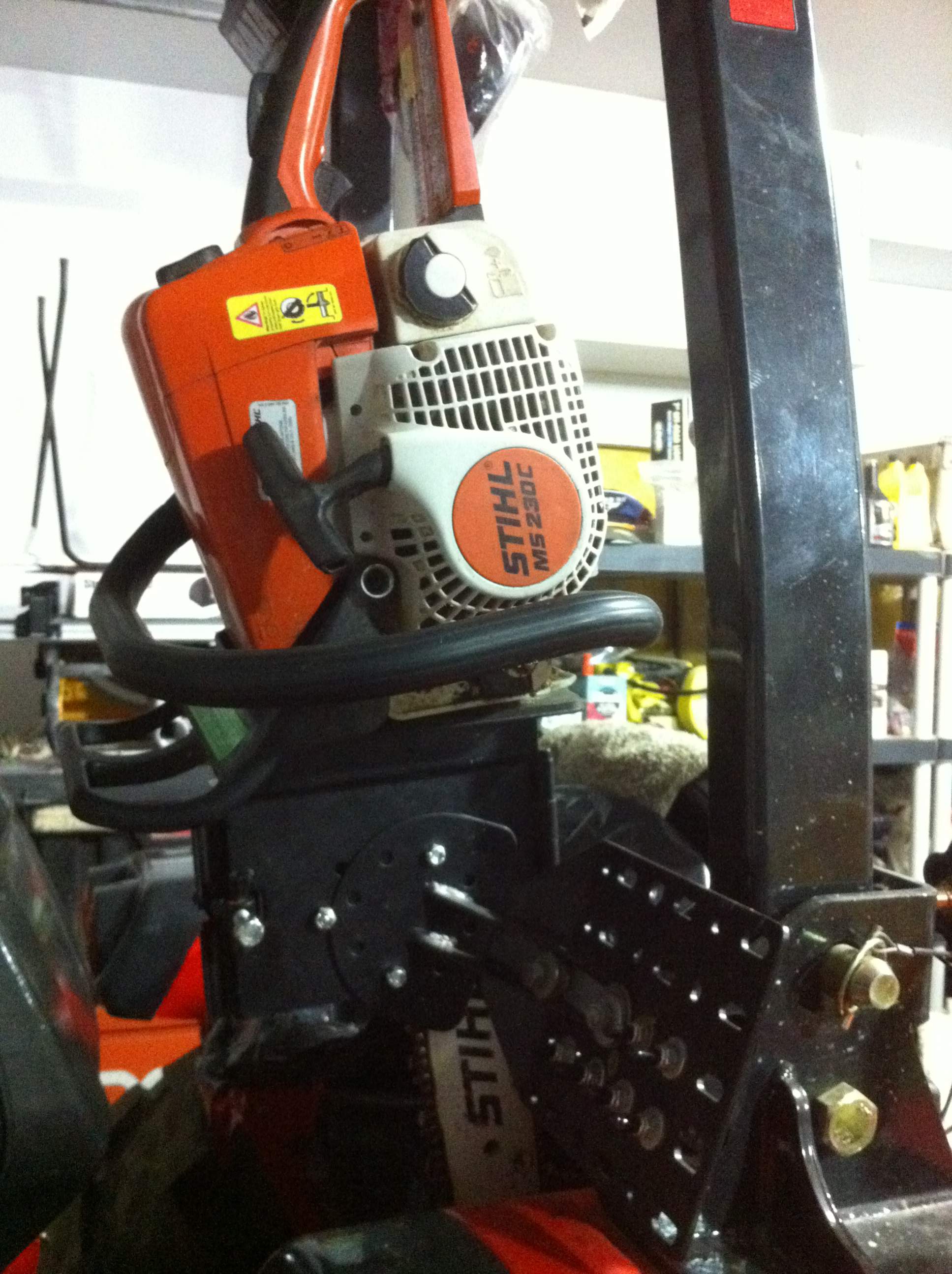

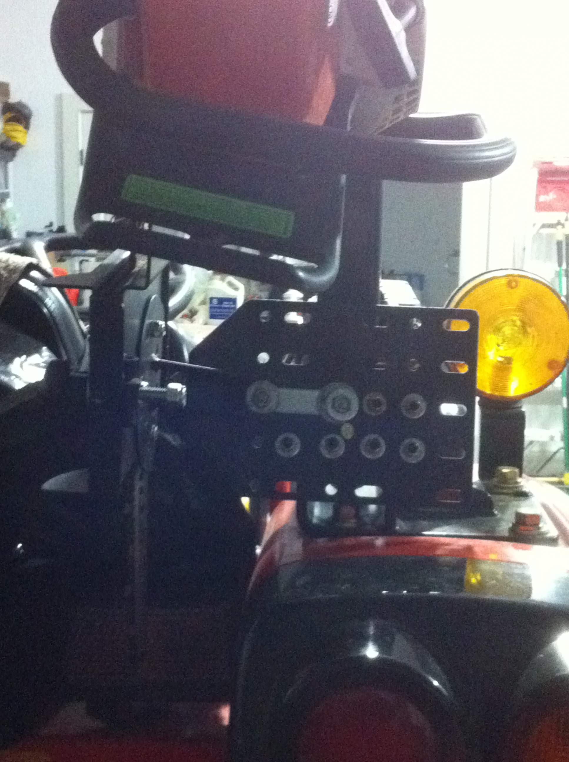

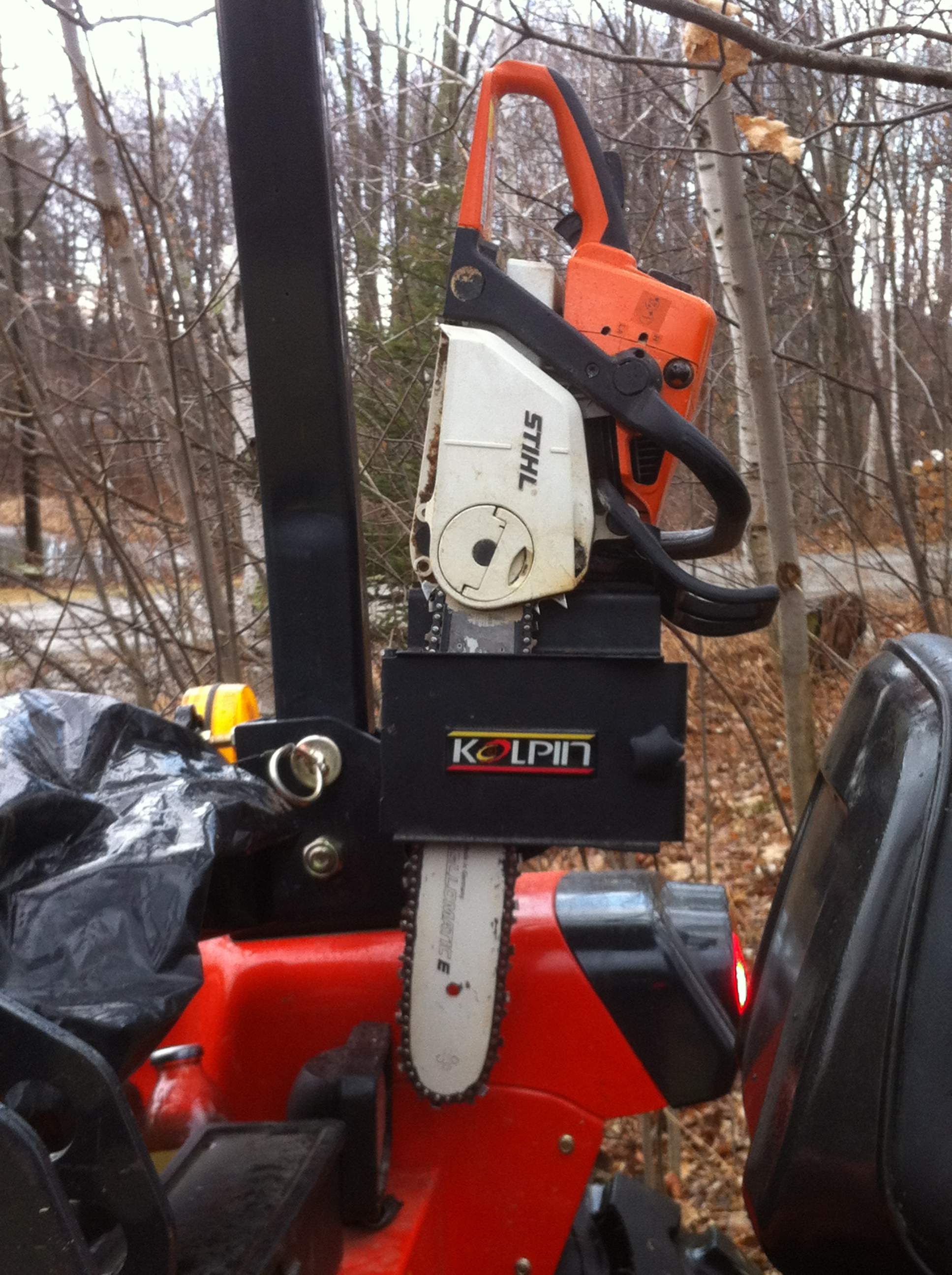

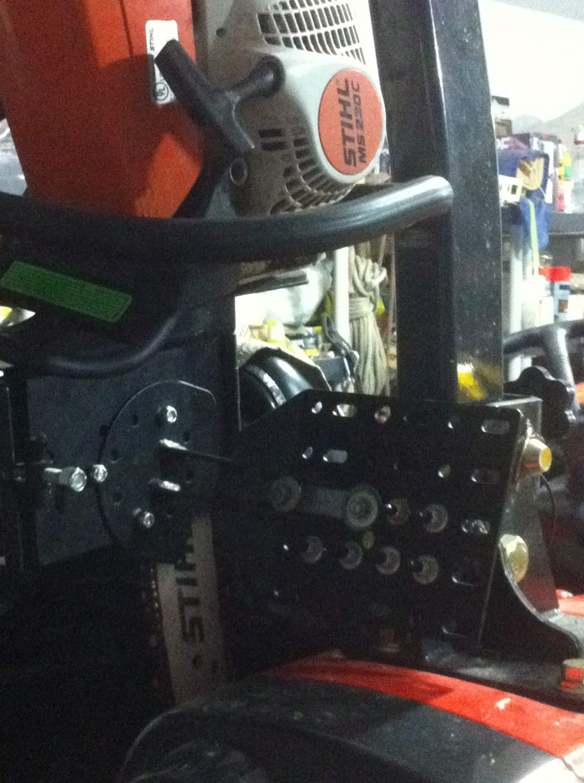

CM, is yours mounted on your DK's ROPs? Would love to see a pic. Trying to think how I might mount one on my cab tractor. Eric's shop-made design looks like it would give more protection to the saw, but this one is pretty slick.
Yes I mounted it by attaching it to the ROPS right side BRACKET. No cab in my case, and the saw is well protected and easy to remove. The L shaped seat that the saw body sits on along with the hinged door with knob to secure the door with a few turns works perfectly. I gave a lot of thought about how to mount the saw press and have not had to do anything to it since first installed. I'll see if I can find a pic.
Side note: since erik choose to put me on his ignore list, he's missing out on this whole discussion of the IMHO best saw press for the money that I know of - now there's irony for 'ya, block me out to one's own detriment, oh well....
Here are the pics:
I looked at the Kolpin, but the press opens the wrong way in order to mount on the window wash bracket where I mounted my saw. I first considered then discounted drilling a hole through the right rear fender to the fender's supporting bracket in order to support the Kolpin, but ruled the Kolpin out considering that if I needed to fab a bracket, I could fab a better solution that would be less fiddling to get a chain saw on and off the tractor.
Here are the pics:
View attachment 399395View attachment 399396View attachment 399393View attachment 399394
Thanks for the pics, CM. Since my tractor is set up the same as Eric's, I think he's right about the way the Kolpin press opens preventing it from mounting on the rear windshield washer tank bracket. Doesn't look like it could be reversed without deconstructing it. Could probably mount it on an FEL arm, but that would leave it a bit too exposed for my liking.
No problem. It took forever to find the pics. FWIW, I mounted the Kolpin press by using U-bolts that pass through the mounting plate and through the holes in the back of the ROPS mounting bracket. I know the press won't work for every application, and especially so for cab tractors, but putting it out there may be useful to someone without a cab, or one who might find a way to make it work without too much modding. I was pleased to get it to work with no holes drilled, and no need to fab anything since I don't have any welding equip any longer.
