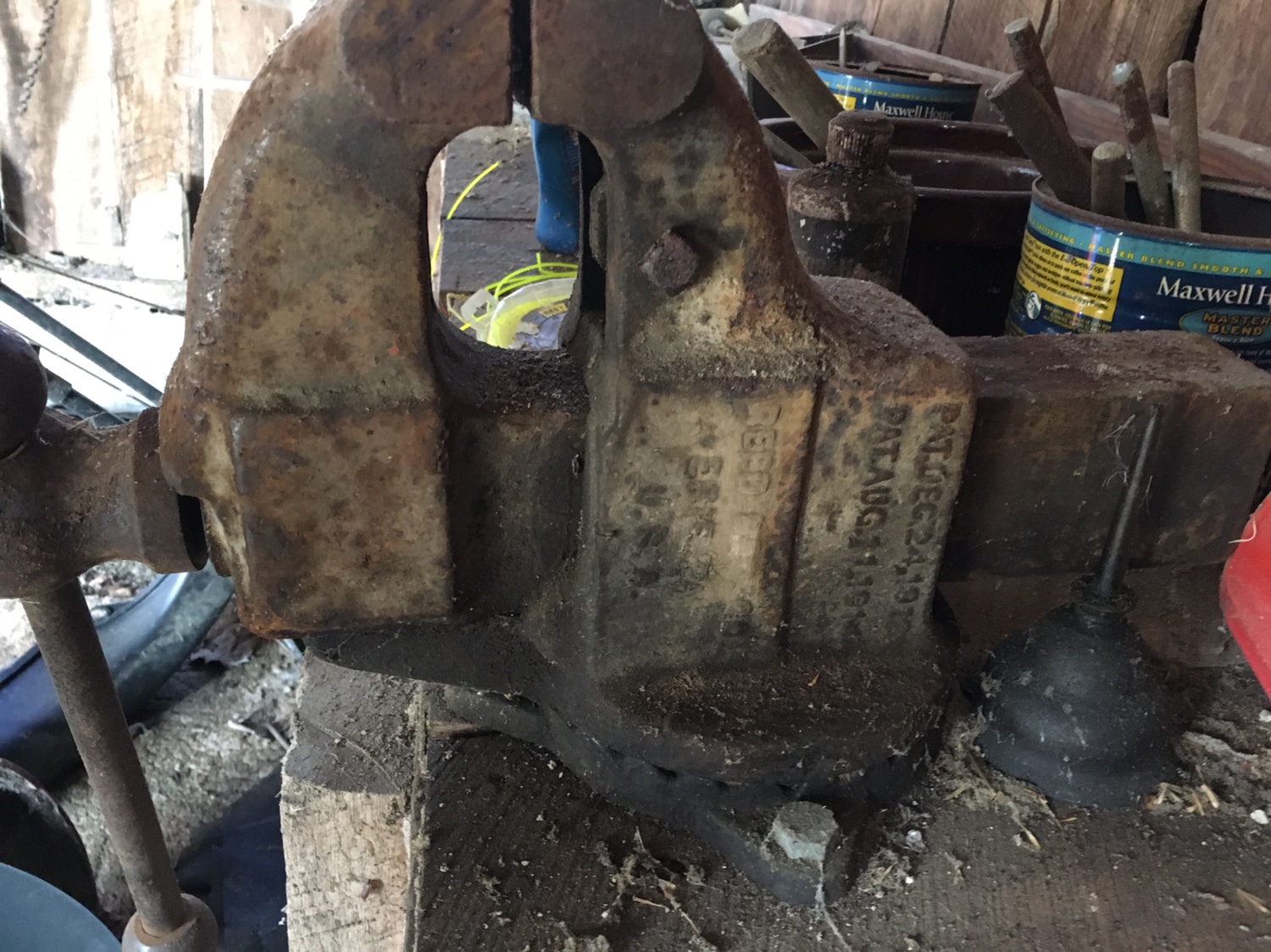

Found this in my great aunts shed. Does anybody know any details about this vise. It appears to be in good mechanical shape.
   / Good Bench Vise Recommendations #207

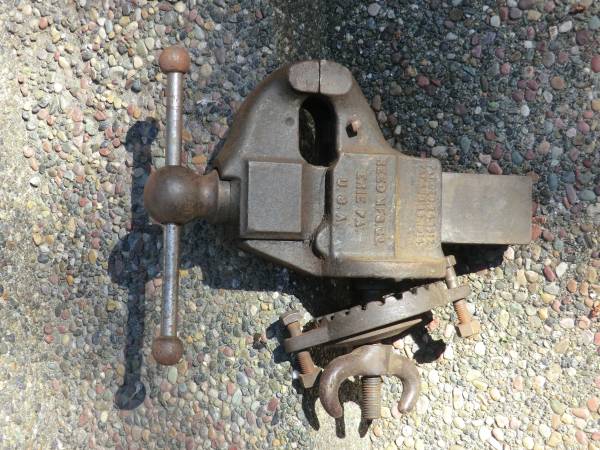

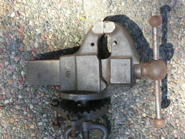

Alan: you've found a nice old 1920's (or 1930's) Reed #32 combination vise. it's missing it's pipe jaws, but since it's maybe been sitting on your uncle's bench for 70+ years maybe the jaws are laying on the bench. that is one of Reed's first swivel base vises where the adjustment was on top of the bench instead of down underneath it like my old Reed #31. with the pipe jaws removed (or maybe missing) a lot of users liked them out of the way cause the deep throat gave them a few more options.
I posted a picture of my Reed 4c that is a newer and much bigger version of yours a few posts back and here's a few catalog pages and pictures of my old Reed 31.
it's worth some money (not a lot), but since it's a relative's and in pretty good shape once you clean it up i'd take it home and re grease it and it will last the rest of your life if you don't use it as a press, or anvil, or put a pipe on the handle to get more grip (use copper jaws for more grip).
More than likely it was my great granfathers.
Going through everything since my great aunts passing has been like opening a time capsule.
