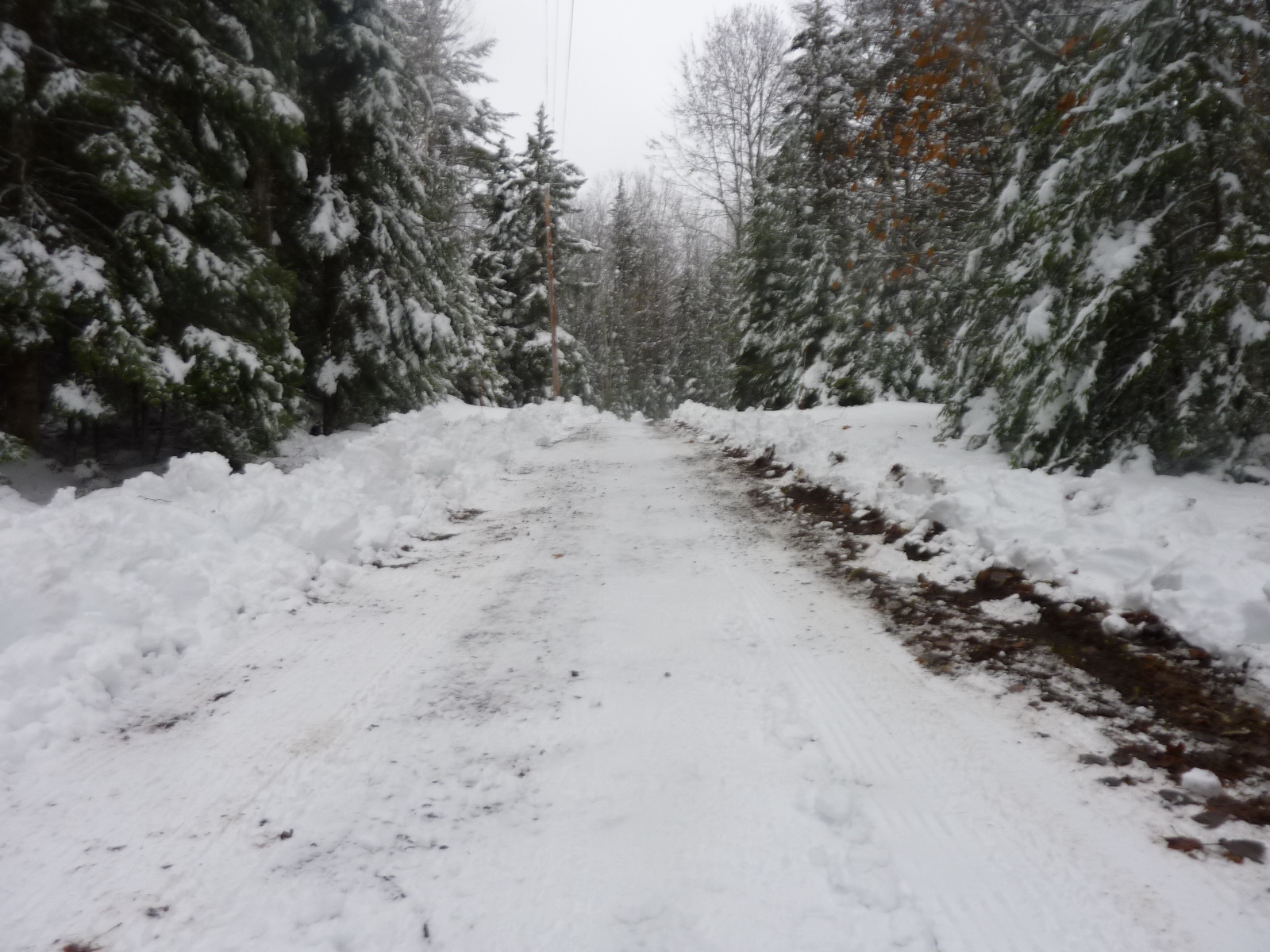

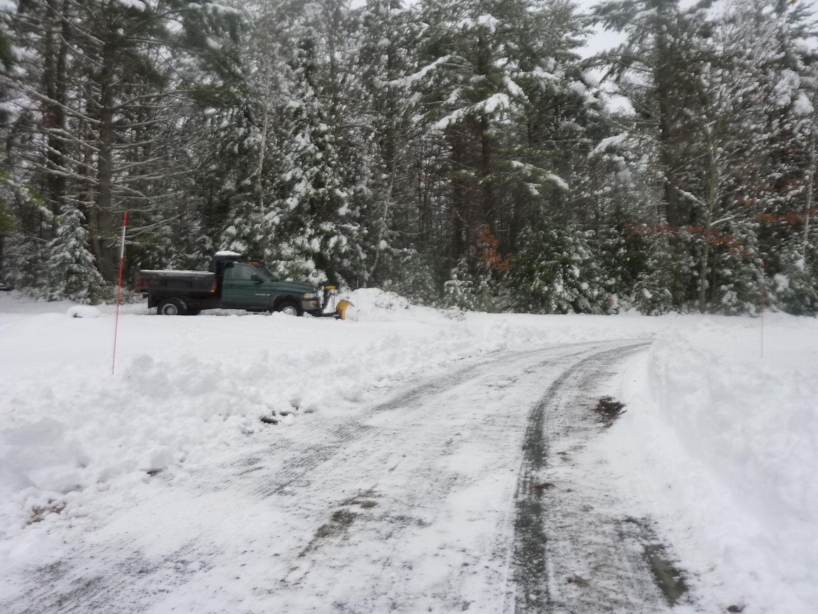

How well do the shoes keep the blade from digging in. .
I thought today would be a good day to dredge up this year old thread so you could see why I use plow shoes. We got 10" of heavy wet snow. It stopped snowing shortly after noon time. This is the first time I plowed this season. Our gravel road is not frozen and we have had a lot of rain lately. The plow shoes saved me from tearing things up and making a mess. Turned up some leaves here and there is all. One ton Ram 3500 with a 9' Fisher.
This is what those shoes I built up last year look like now after one plow season.
gg
