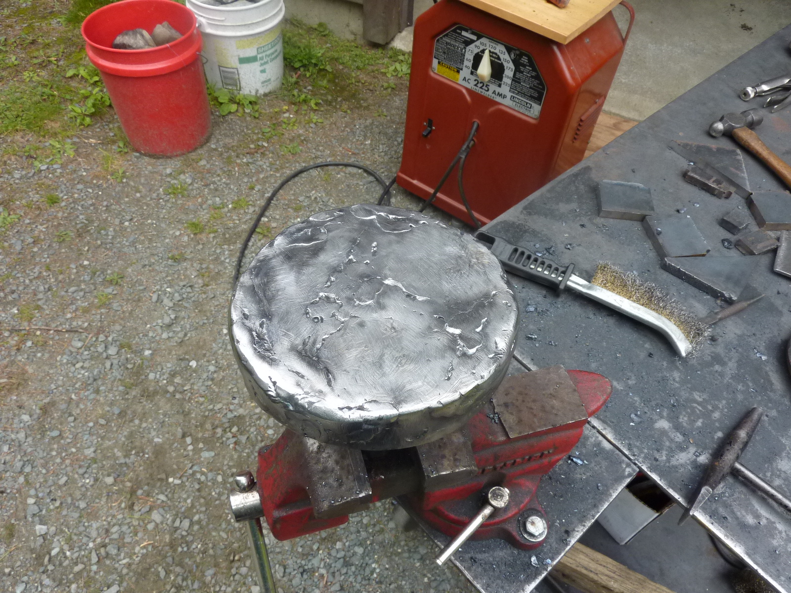

Practice, experiment, or just burn some rods and end up with a useful chunk of steel instead of junk. If it doesn't come out perfect don't worry. No one will see and it will be all ground off by next spring.

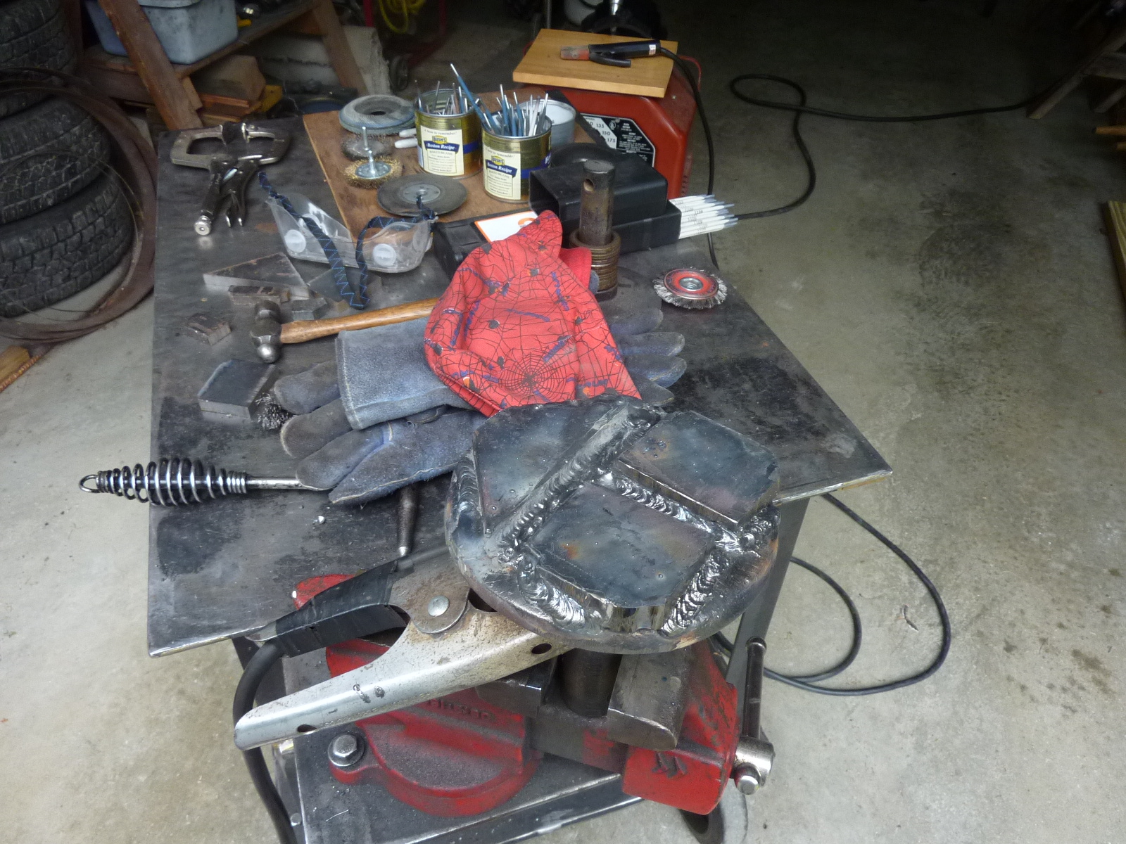

I am doing my Fisher shoes. Used 6011 to welded on some 1/2" pieces from the scrap bucket.
Filled the spaces and build up the edges with 6013 then ground it flat.
Interwove a couple layers of 7018AC on top.

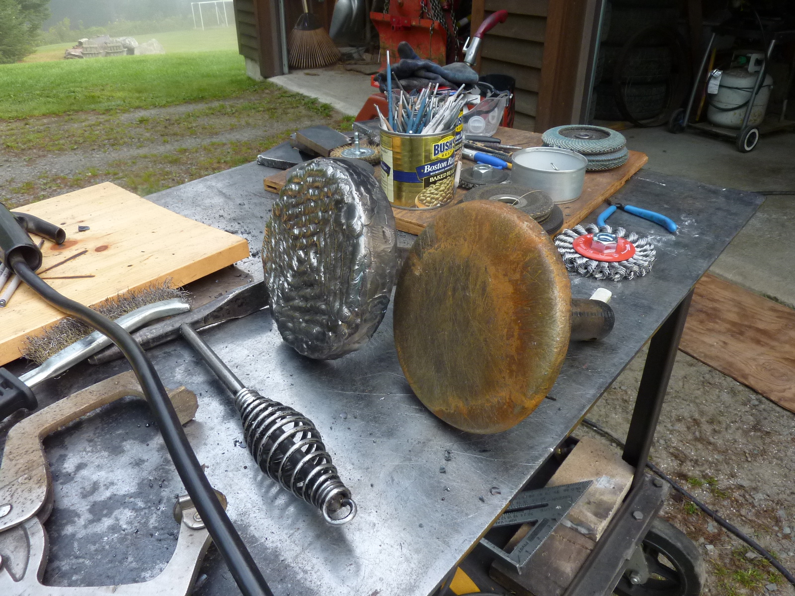

New and old. You can see I could be a lot steadier at hand and my eyes aren't overly sharp.
My wife came by. She said what on earth are you doing? That is a lot uglier than the stuff you usually make :)

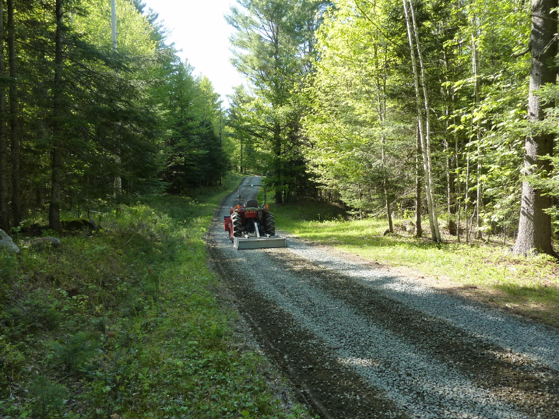

You are right except maybe your 99.995% number is a way high. For me anyway. Where we live almost all the roads and drives are gravel. We only have one asphalt road in our entire town. It snows a lot before the roads freeze and again after they thaw. I run shoes all season long as do all the town trucks. I would much rather wear down an easy to fix or replace pair of shoes instead of my cutting edge or edge trip spring brackets. If the shoes weren't there it would be those other parts wearing away.
Just as an example this is our road. It is a mile long. You might call it a trail.
