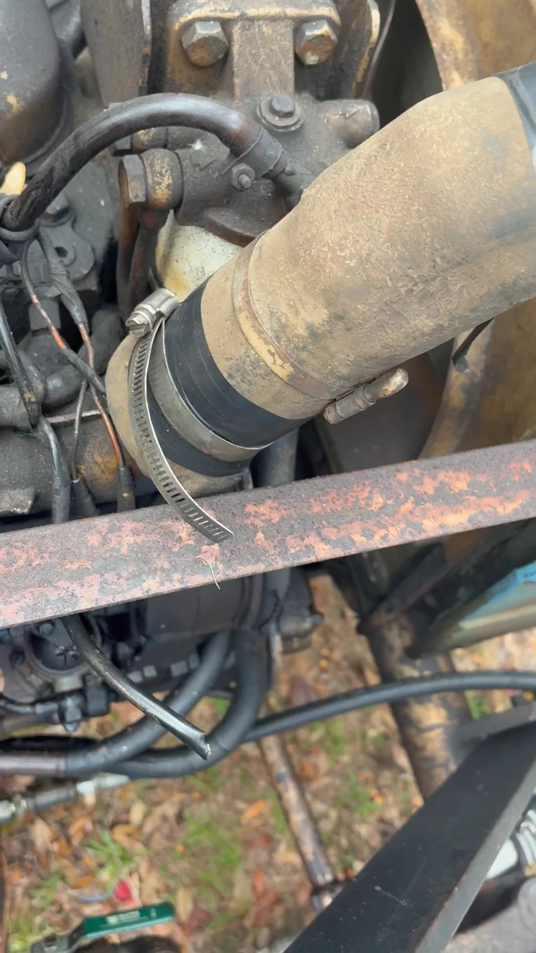

Hello everyone, I have a Long 350 with a Perkins engine. The tractor was running fine. I turned it off and went to start it again on a different day and it is acting like the battery is dead. The battery is brand new - bought it in Oct - and it was starting the tractor just fine. I took the battery out of my Tundra and it is doing the same thing. I had the first battery tested under load and it shows it’s fine with 900 cca. I know little about gas engines and nothing about diesel engines so I’m seeking help on diagnosing it.
I’ve checked the ground cable to ensure it is tight against the block and that the cable is tight on the battery and the terminal is tight on the cable.
My thoughts are it is either 1) a starter issue, 2) the hydraulic pump that is running off of the front PTO that is used for the loader is locked up restricting it from turning over properly or 3) it is some type of vapor lock or something internal.
Can anyone provide input on how to properly diagnose the issue?
Here’s a video of me trying to start it:
Any help would be greatly appreciated.

So many times folks with the exact problem find out it is a bad connection. Usually the negative battery cable to frame connection. Just because the connection is tight doesn't mean the connection is good. Try using jumper cables directly from the battery to the starter. If this works then you have a bad connection(s) or a bad cable(s) or both.

Okay, wanted to update everyone on the tractor. First, thank each and everyone one of you have provided a comment. I really appreciate you taking the time to comment and all of your help.
I was able to get the tractor to turn over:
Video of tractor turning over
By a slight margin, the majority of the comments indicated a bad ground. I bought a new cable from Tractor Supply and cleaned the ground mount and installed the new ground cable and it turns over as you can see in the video.
Unfortunately, I couldn’t get it to start but that could be that it’s in the low 50s/high 40s here in Florida today. It smoked a lot, but would not fire. To my knowledge, it doesn’t have a block heater so I’ll just have to wait until this weekend when it’s forecasted to be in the low 70s. If it won’t fire then, I’ll be back to see if I can get some help in getting it fired up.

Your second video shows definite improvement… if the only thing you did was to replace the ground cable, that cable was part of the issue…
How long has it been since you replaced the fuel filter?

The video appears to show your starter motor issue is fully resolved. No glow plugs on that motor? If it has them, did you activate prior to start attempt? If yes, then the switch or relay that preheats the glowplugs may be defective, but having 2 independent problems at the same time seems like low probability to me.

If it has glow plugs, check for voltage at them along with current draw. Could also check resistance of each, but AMP draw is better test.
