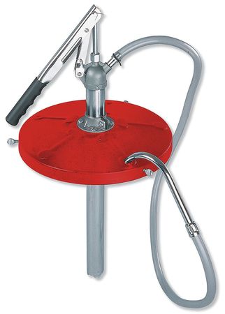

Dataway, this is the 5-gal pail Westward pump I've used for about six years. Excellent manual pump for hydraulic oil.
https://www.amazon.com/Westward-5NUD5-Lever-Action-Bucket/dp/B004ZRR9NK

Dataway, this is the 5-gal pail pump I've used for about six years. Excellent manual pump for hydraulic oil.
The reason I recommend the Westward pail pump and those of like design is that it replaces the plastic cover of the bucket and fastens to the lip. That gives lots of rigidity when you're pumping with one hand. Makes topping up quick and spilless between changes, but still delivers high volume for complete fills. Note, though, that they aren't intended to provide a tight seal on the bucket like the original plastic cover. So with a new, full bucket of fluid, you cannot slosh it around. :)
