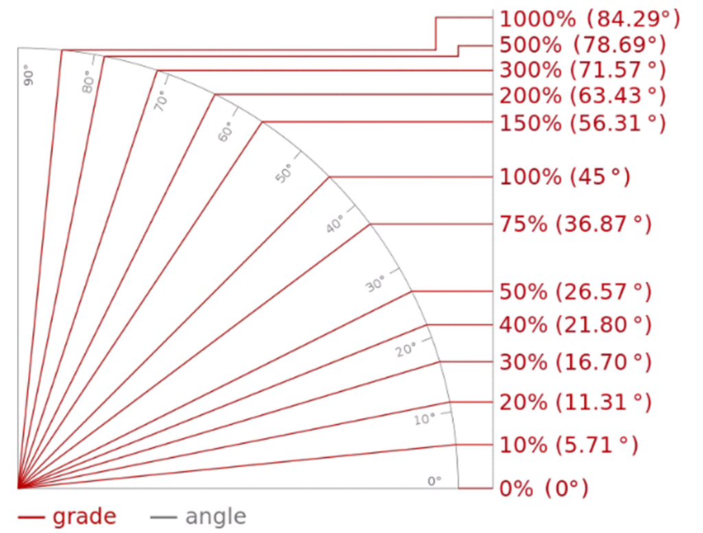

I have a new Holland tc 18. The back of my property has a gradual decline of 100 ft. and then sharp 45 degree drop into a river basin.------------ Any suggestions or input is appreciated.
How did you determine that it is 45 degrees?

I always wondered who decided that if a 45d angle is a 100%, why is a 90d angle a 1000% grade.

I'm pretty handy with tools/cutting so knew what a 45 degree angle was. The hill is 45 degrees.
A 90d angle is an infinite percent grade. A 1000% grade is 84.29d.
From: CSGNetwork.com Free Information - Calculators, Converters, Apps and Source Code
"A 100 percent grade would be equivalent to a 45-degree angle or, in other words, the rise would be equal to the run. It is also possible to have an infinite percent grade as that is defined as any amount of rise with no run at all. This would be equivalent to the road going straight up at a 90-degree angle"
