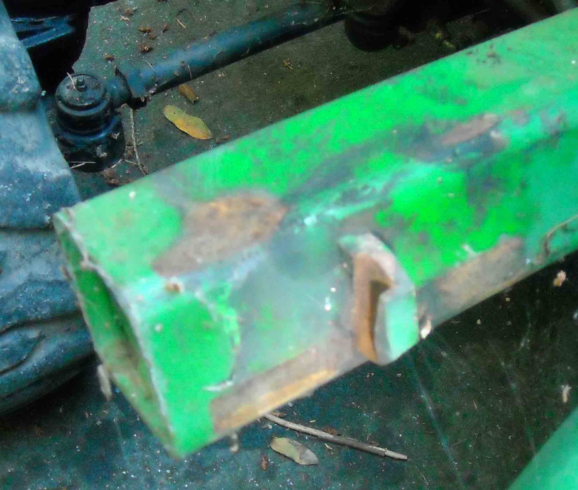

Yeah, I forgot about that. I am very happy with how tight that FEL was
after my repairs. My 2001 FEL is sitting here now, and it is much worse
than the other one. The good news is it is easily fixable. I will do
a thread when I get to it. In the photo you can see how the locator
tab is worn almost halfway thru. This as well as the surface wear on the
square tubing makes the FEL extra wobbly.
The 420 FEL has wimpy cylinder rods (25mm) that bend easily, too. The
430's are thicker, as I recall.
