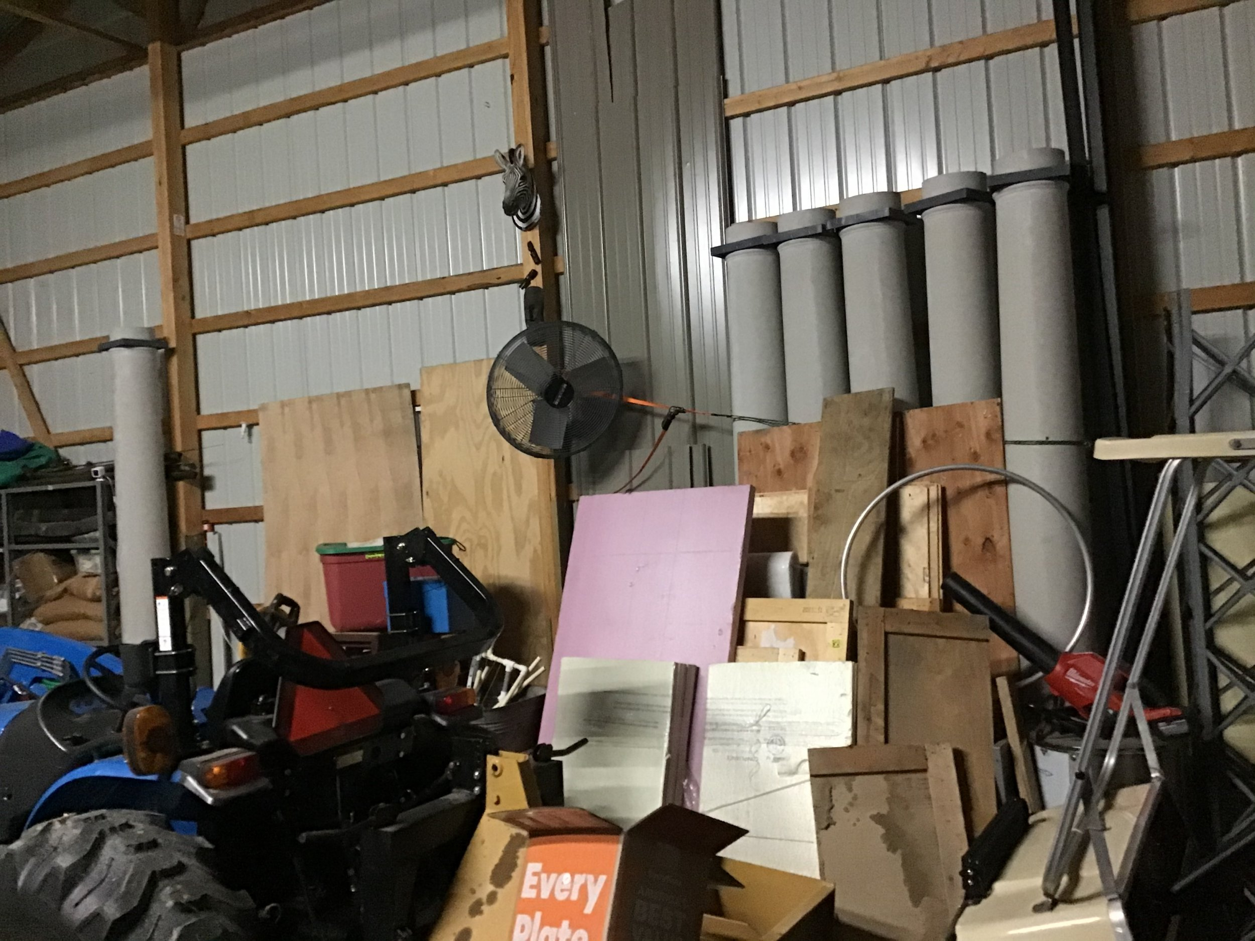

And here I was, when I read the title, picturing a big mansion with huge pillars on the front porch! Even my Wife missed the "looking South" concept!
David from jax
:) I’d love to build a plantation style house. Heck I already have a few of the pillars.
