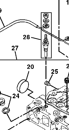

I got my 2210 last January off ebay, and it has worked out just fine. I was surprised, though, to discover there is not a glow plug for starting. Does it start just by compression? How will this arrangement work out next winter when temps can get well below zero? I've used a block heater in the past with other brands of tractors, but they all had glow plugs. Is the lack of a glow plug on the 2210 anything to be concerned about? Thanks. . . .
   / Glow plug #2
Your 2210 does indeed have 3 glowplugs! But unlike what you are probably used to, they do not have a separate switch, or light on the dash to tell you when they are on.
The glowplugs are energized when the key is in the start position, while the starter is cranking. Some engineer at JD thought this was a good idea:confused: My 4110, 4010, 2210, 4115 are all the same, and probably more that I cannot think of...
To make starting easier in cold weather, I either pull up the PTO button, or leave the tranny in gear and turn the key to start for 5-10 seconds, then put in neutral or push the PTO switch in. That gives the glowplugs a chance to heat up without the starter cranking.
   / Glow plug #3
Huh, 2210s have glow plugs. Part #28 in the attachment.

Kennyd is right: The tractors I've had in the past (no names, but they were all bright orange!) had a separate switch for the glow plug and a light on the dash to tell when they were on. With no switch and no light on the 2210, I just figured there was no plug. The things that can be learned on this web site due to the willingness of others to share information are pretty incredible. Thanks!
