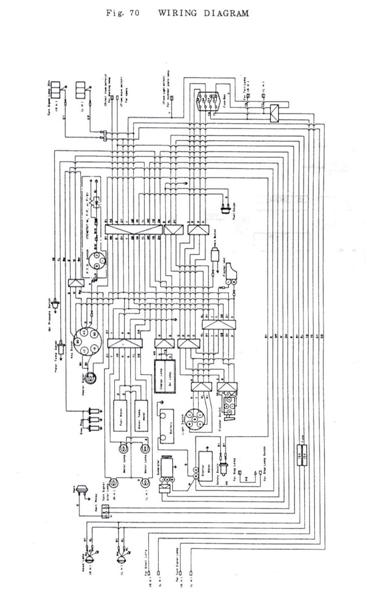

In previous posts have advised about my wiring harness woes..on a TL 2300...FRIED.....maybe someone can help me figure out the glow plug....so as I rebuild the wiring harness I can get it right...before I disassembled the harness the glow plug wasnt working.....I must have a good engine as it would even start in the low 30's........
Problem 1.
On the left side of the dash is a button.....no not the horn that is one of the few things that works.....but next to it......when pushed this button makes the electrical idiot light come on........this is the only idiot light that works.......thought for a long time that this was the glow plug........but while takin apart the wiring discovered that the glow plug indicator is a resistor coil and has it's window over by the key......WHAT IS THE PURPOSE OF THIS BUTTON????
Problem 2.
The glow plug indicator never comes on nor do the actual glow plugs on the block get hot.......Lens12....thanks Bud....sent me a schematic.....yes, I need a manual BAD....any deals?..........the schematic shows that the glow plug indicator has a wire going from a terminal on the key switch, through the resistor, and back to a different terminal on the key switch........my wiring....which had been rebuilt once already I think......had 2 wires going to the correct terminals with a third pigtailed going to the resitor.....could this be right?..........or is the schematic right?..........then the other real question is...............how do you actually get the glowplug to work.......???????.............I imagine it is possibly a key position.............perhaps holding to the left?........well, enough for today.......thanks for YOUR help........

Dennis,

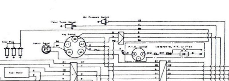

I have a TE 4270 (European equivalent of TL 2500F). Whilst not the same model as yours, wiring loom according to schematic in my parts catalogue shows a paired connection from terminals 17 & 19 of the key switch to the glow plug indicator and continuing directly to glow plugs.
To get the glow plugs to work, turn and hold the key switch to the left. The past 3 mornings we have had 4" snow, morning temp of -4 deg C. (25degF) It has taken about 30-40 secs in this position before firing. Glow coil indicator will show after 10 secs, but will not fire at this point.

On mine, I do not have the button mentioned, but have a dash mounted on / off lever for the electric PTO clutch. Could your button be a push / push switch for the clutch? /forums/images/graemlins/confused.gif

Hi Nigel,
If you have a scanner, post a partial pix of the wiring... and it will be easier to follow... (for me anyhow) /forums/images/graemlins/blush.gif /forums/images/graemlins/smile.gif
   / Glow Plug #4
John,
Scanned copy of wiring diagram. Hope this clarifies

Attachment 2: Close up of switch connection

WOW......JOHN.....this is fantastic.....the wiring diagram that was sent to me is different than this one.....but yours is TOTALLY wired like my glow plug and key switch........what manual did this come out of?
Mine doesnt have the PTO switch.....but gollllly gotta study this......THANK YOU so much

Sorry, to keep size within forum limits means a reduction in definition. If you want to send me your email address on private forum, perhaps I could e-mail it to you?
Manual is genuine Iseki parts catalogue for TE 4270. Printed in Japan 1985 by Iseki Foreign Affairs Division. Was able to obtain on-line from a regional dealer only 9mths ago. Not bad considering it is a 17yr old model /forums/images/graemlins/smile.gif
