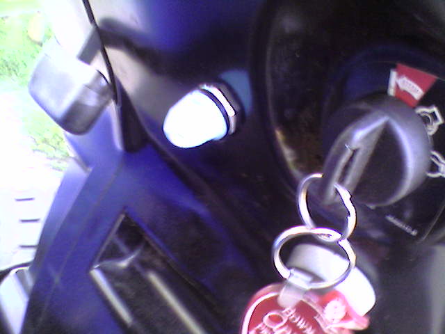

Mine did the same thing. It would come on, go out, come and stay on for a while.
I had to have some other work done on it so the shop foreman ran a toggle switch out the steering to turn on the plugs and I reworked it to give it a easier and better looking appearance. Two wires are all that is needed and a push button switch and I cut a finger out of a mechanics glove that resembles a surgeons glove and put it over the button and put a small tie on that has been there all summer and this winter. Just count four seconds and hit the starter.
