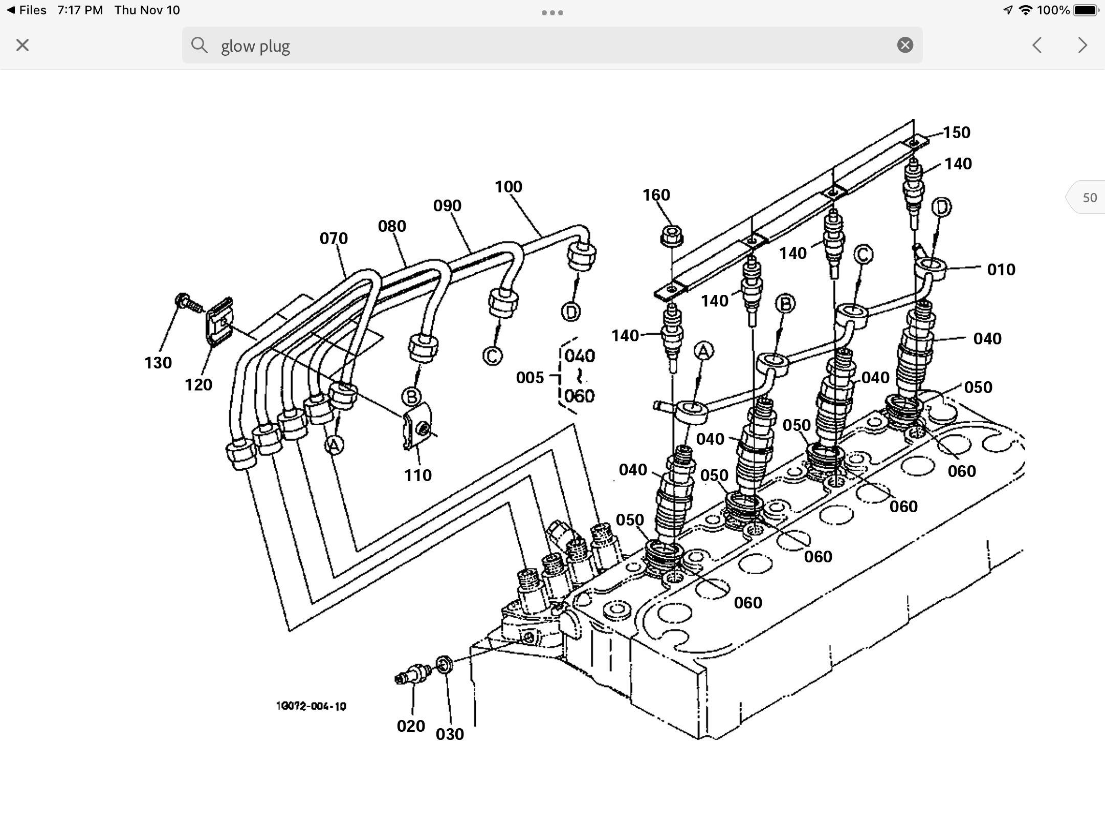

Hi -
I rolled my B7800 1 month ago on it's left side. Had it back up on it's side within an hr. Oil level still at the full mark on the dipstick. I want to pull the glow plugs and crank it over to make sure all oil is where it should be, but wondering if anyone had a picture of where the glow plugs are? Thanks in advance

Look on the right side of your engine near the top. They look a lot like spark plugs but instead of a heavy wire and rubber boot there's usually a nut holding a terminal and a regular wire. You could also just crank it over by hand.

   / Glow Plug Location B7800 #5
On the top of the engine you will see the fuel lines going to the injectors. Next to them is a flat metal bar with nuts protruding. Per below, Item 140 are the glow plugs.
   / Glow Plug Location B7800 #6
