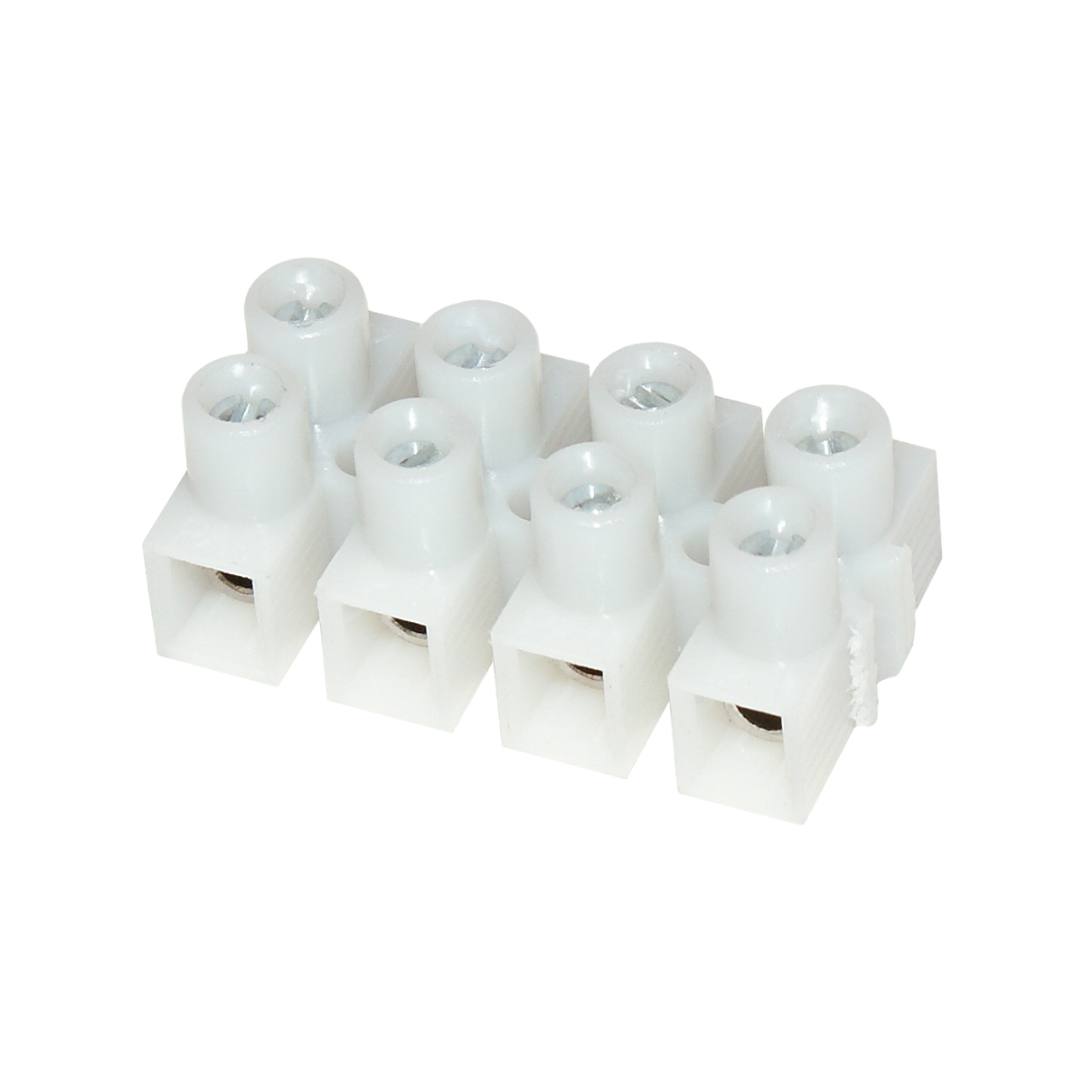

   / Glow Plug Kit available for Y385 engine? #27
Well, 30A would have been sufficient. The correct wire gauge for a 40A would be 8AWG. Nevertheless, I'd recommend your wire conversion to be a parallel configuration rather than series. In a series circuit, any open will isolate the components on the far side of that open. In other words, a broken or disconnected wire will result in no voltage being delivered to the GPs on the other side of the break. Get a simple 30A terminal block, and configure it for parallel distribution; 1 in, 3 out. For a little more money, you can get terminal blocks pre-configured for parallel output. You feed it with your new 10AWG, but can use lighter gauge wire from the block to the individual GPs. Reason being, each individual GP will only draw only up to 1/3 of what's being provided to the block.
//greg//

#28
Good suggestion on the wiring setup. For now it works as is, so I'm not messing with it any more! When it's warm and I feel like tinkering I may go retrofit it, or when glow plugs start failing, until then I'm good to go. Man is it nice to be able to fire it up instantly again, had to use it yesterday to do a few chores and it was 15 out.
