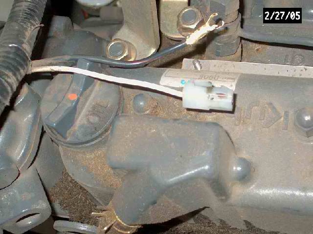

I have a Kubota B7200. Prior to today, the glow plug indicator would heat up and the tractor would start right up. Now, I turn the key to the left, wait up to a minute, and no heat, the tractor did not want to start. It finally started. I shut it down, let it sit and tried it again - still would not heat up. What could be causing this?

It could be as simple as a disconnected wire. I had this happen to my BX22 and just fixed it. Pic attached. The wire was supposed to be attached to the threaded post you see without a nut on it. Engine vibration must have loosened it and presto. No more glow plugs.
