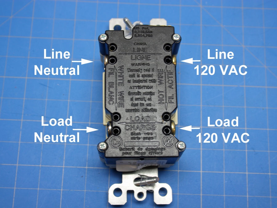

Is there someone who can explain how to correct a GFCI outlet in a bathroom which was initially wired to ALSO remove power from the adjacent overhead light if tripped? Home inspector noted as a non-conformance and a safety issue. The overhead lights need to remain energized if the GFCI trips. TIA Yooper Dave

On the back of the outlet, there should be a 'LINE' and a 'LOAD' connection point. The supply circuit from the panel is installed in the 'LINE' terminal. To continue power to the lamp not controlled by GFCI, attach lamp wires to other terminal of 'LINE', or double up if only one terminal is provided. The GFCI protects the outlet circuit and others that are connected to the 'LOAD' side only.
Hope this helps.
Patrick
   / GFCI Wiring Issue #4
Hope this helps
I am holding a GFCI receptacle in my hand right now and looking at it so I can be accurate. It is a typical unit. In order to power a lamp that is not protected you will need to use a pigtail. This means you will need to connect the power wires to two other wires, such that wires go to the GFCI and the lamp. For example, if you are using wire nuts, the black power wire , another short black wire, and the black wire that goes to the lamp all need to be connected together in the wire nut. The short black wire should be connected to the LINE HOT screw terminal on the GFCI receptacle. The white wire, at least in the USA, should be connected to the LINE WHITE screw terminal on the GFCI. If my answer is confusing I am sure youtube has plenty of videos showing what I just wrote. Your problem is an easy one and I am sure you can wire it correctly.

The back of the GFIC outlet should have stickers labeling the line and load side. Put both wires under the line side of the screw to avoid killing the lights. Or get a wire nut and a short piece of wire. Pigtails the 3 conductors together then put the jumper to the outlet. When I’m installing a GFIC I always install it not to protect the down stream wires unless that was the intended design. It saves a lot of dead outlet calls.
