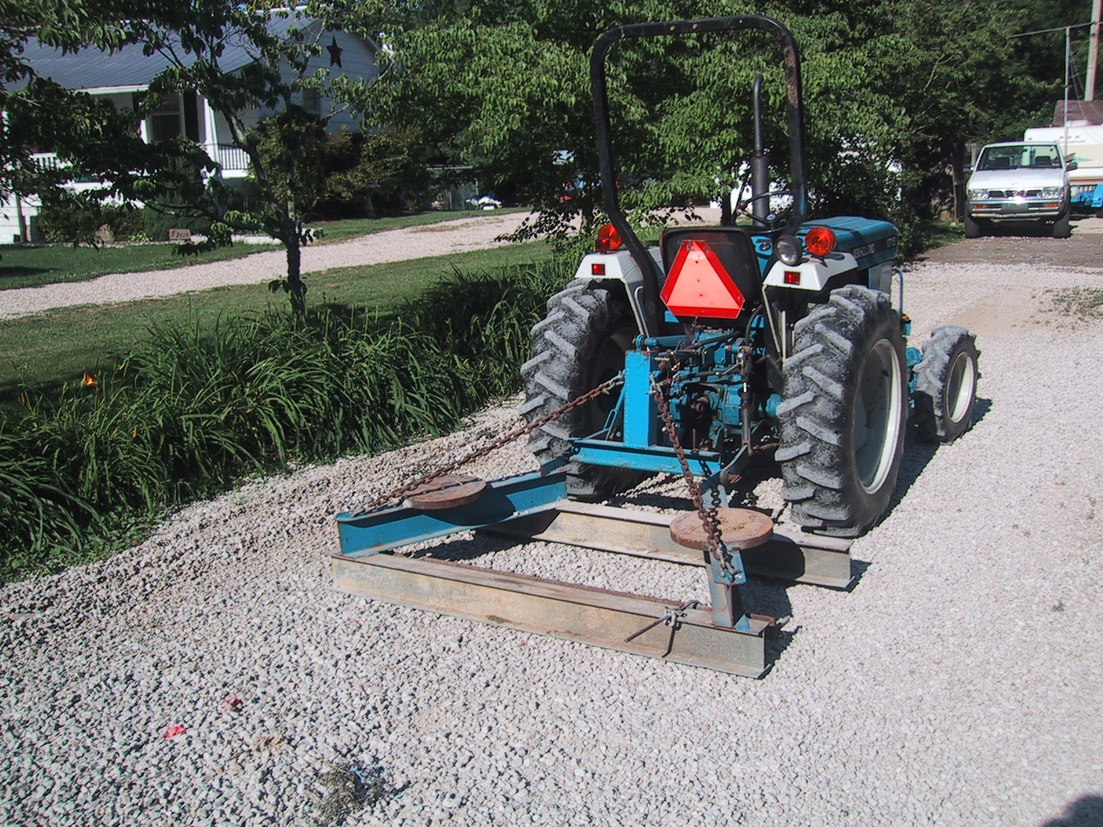

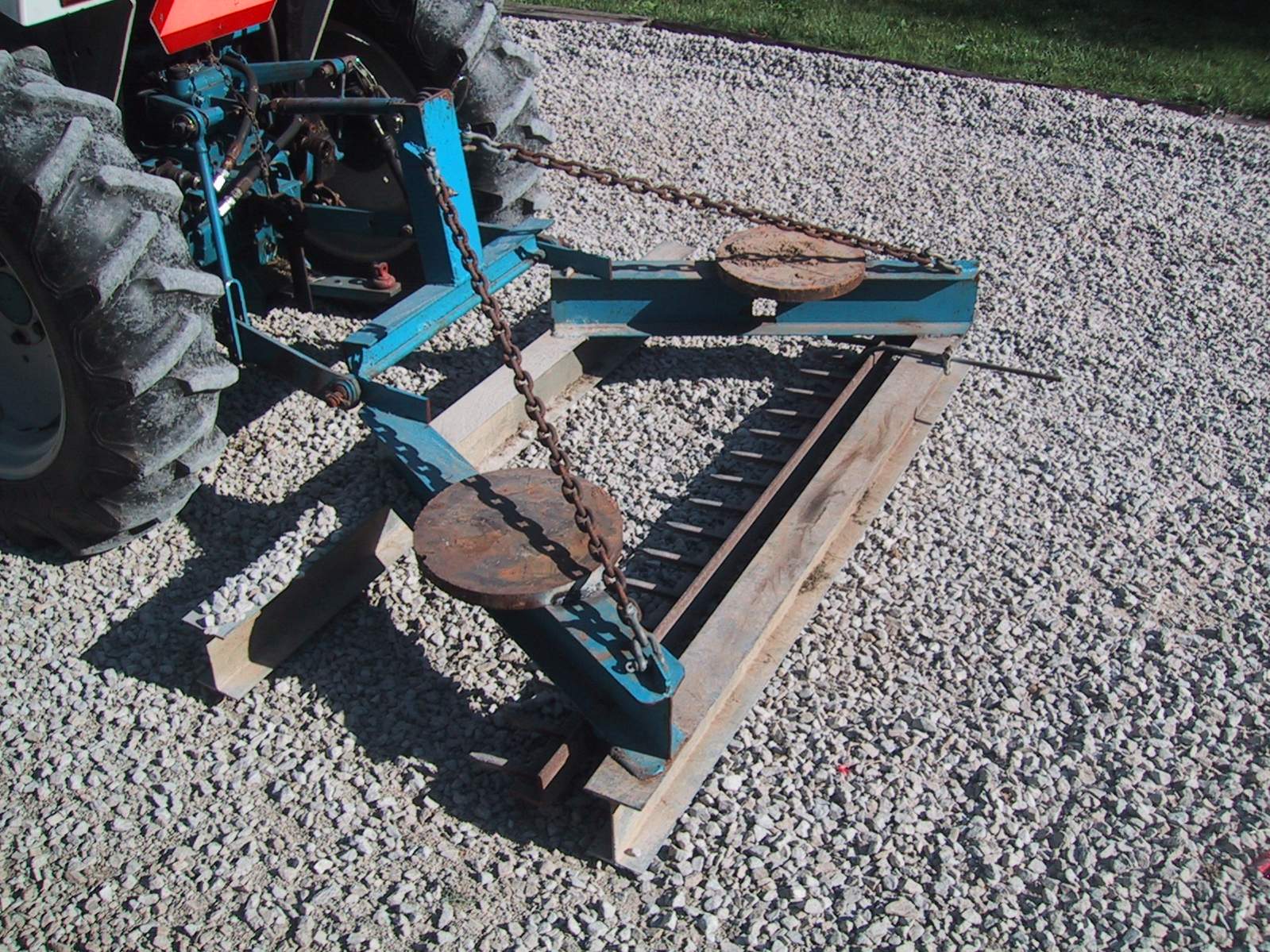

   / Getting rid of grass and weeds in a driveway #15
Here is what I use to get rid of them. Is home made out of Gard rail post and R/R spikes. The spikes turn down to rake grass out . If it gets to bad I turn grader blade up on edge and go deep with it to brake up gravel then smooth it down with grader blade.

thanks all, I guess my point is i'm looking for an alternative to chemicals around the house and lawn. Discing isnt a solution, small rocks/gravel embedded in red clay, hard as roadbase is after a while. At the least it'd beat the devil out of the disc blades.

@ Oldmax
something like that might just work, i'll have to study your photos a little.
good suggestion, thanks.
