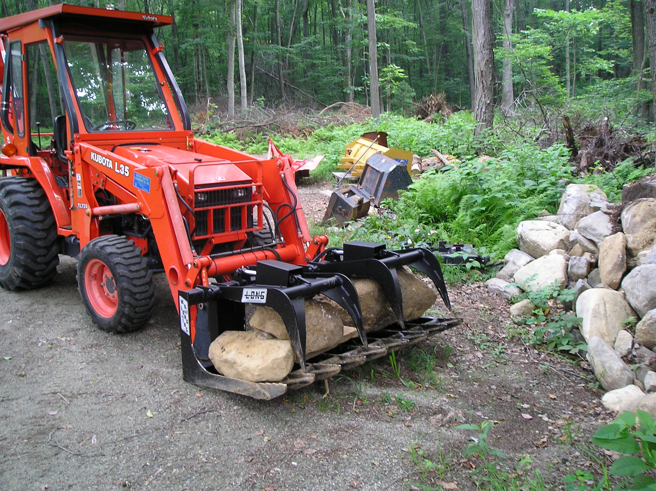

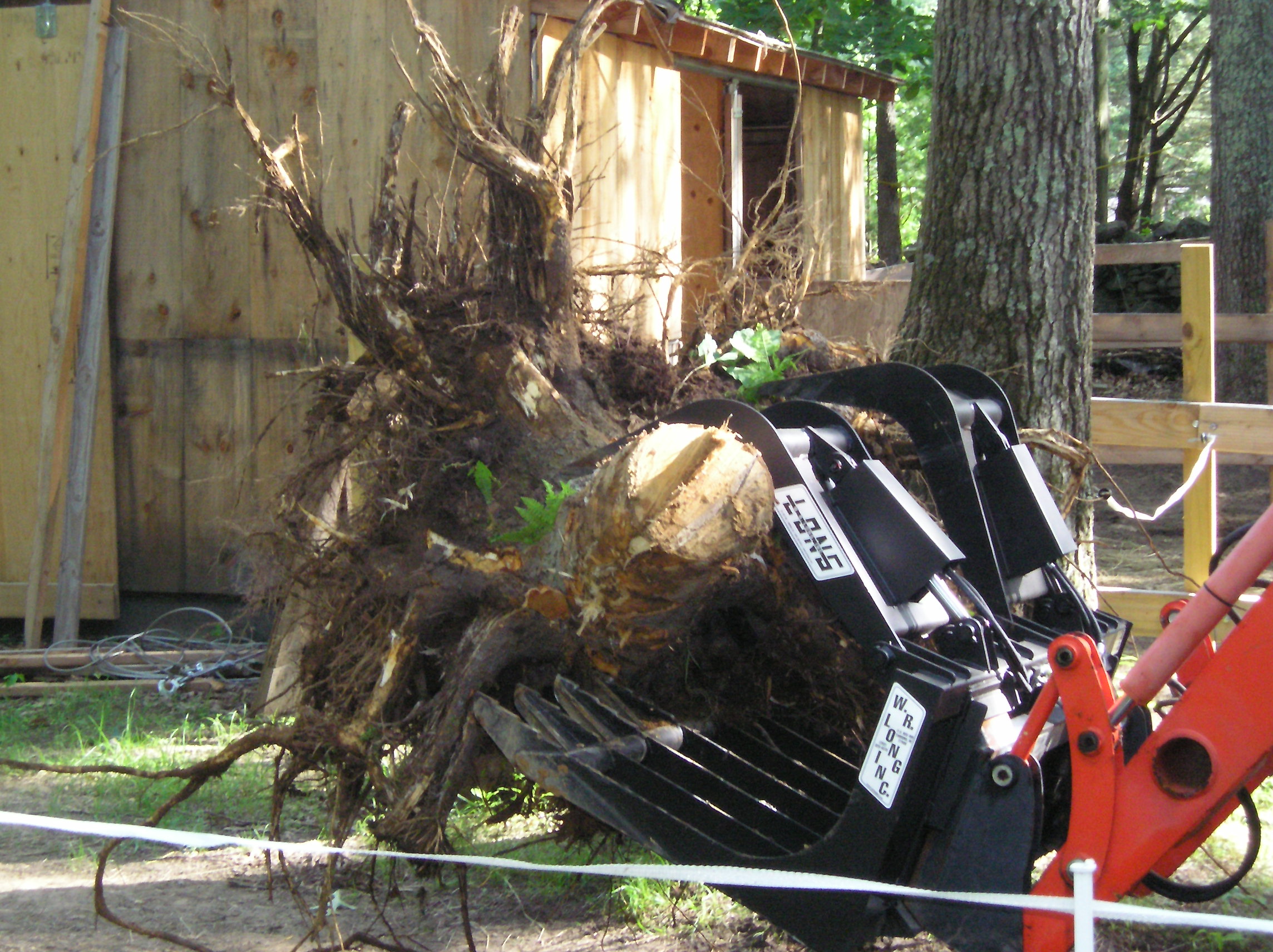

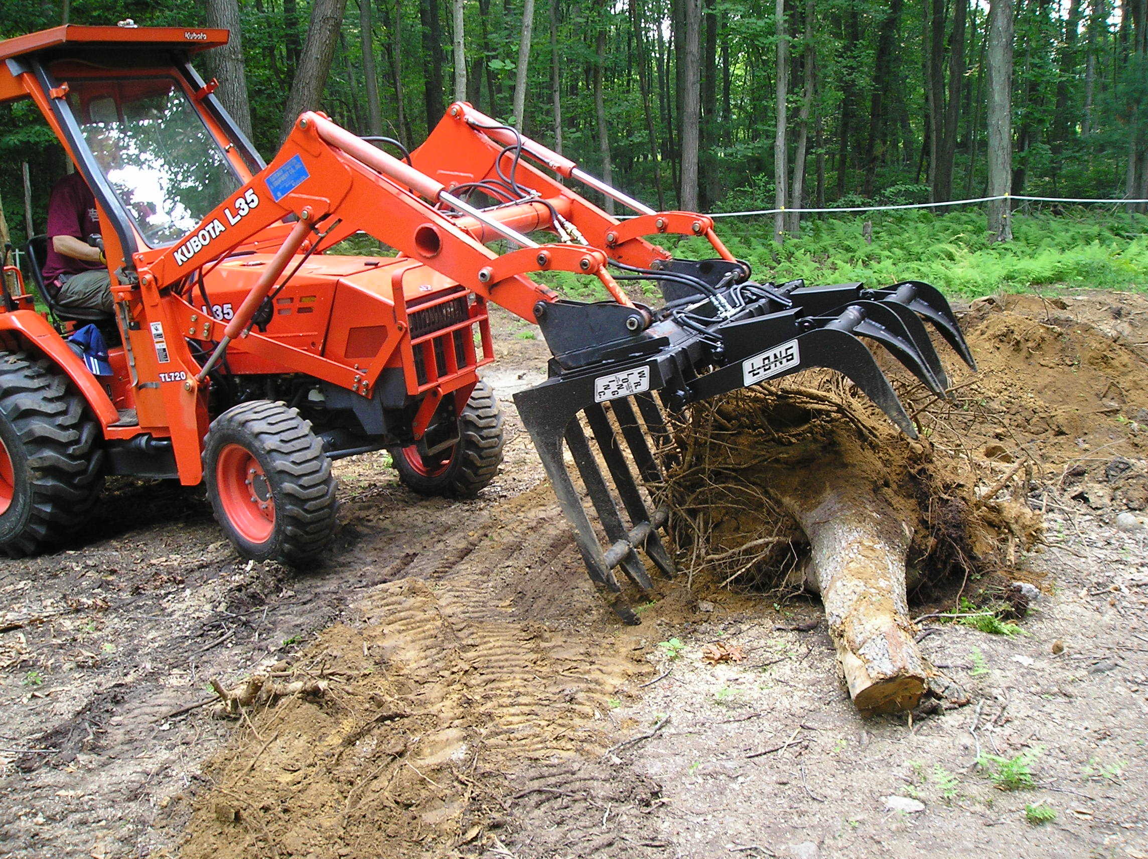

The only concrete work I've done so far was sonotubes to anchor my pipe frame horse barn. This time I need a slab 25' x 30'. I'll have someone else do the pour, I want to do all the prep work. I'll be getting a carport soon.
My tractors have been kicked out of the barn to make room for hay...so I'm getting a plot ready to dig and build forms. Had to remove several large trees and many large rocks, almost done with that part of the job. Will be digging footings and prep work for forms.

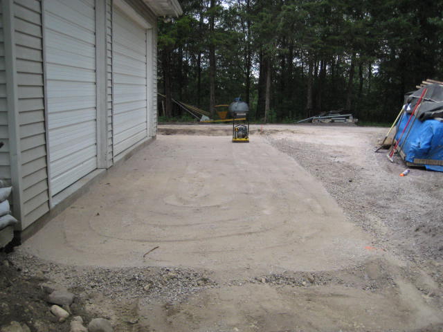

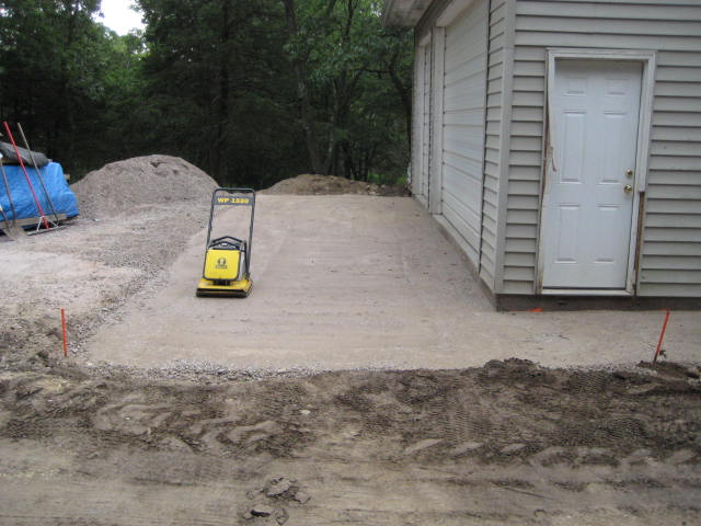

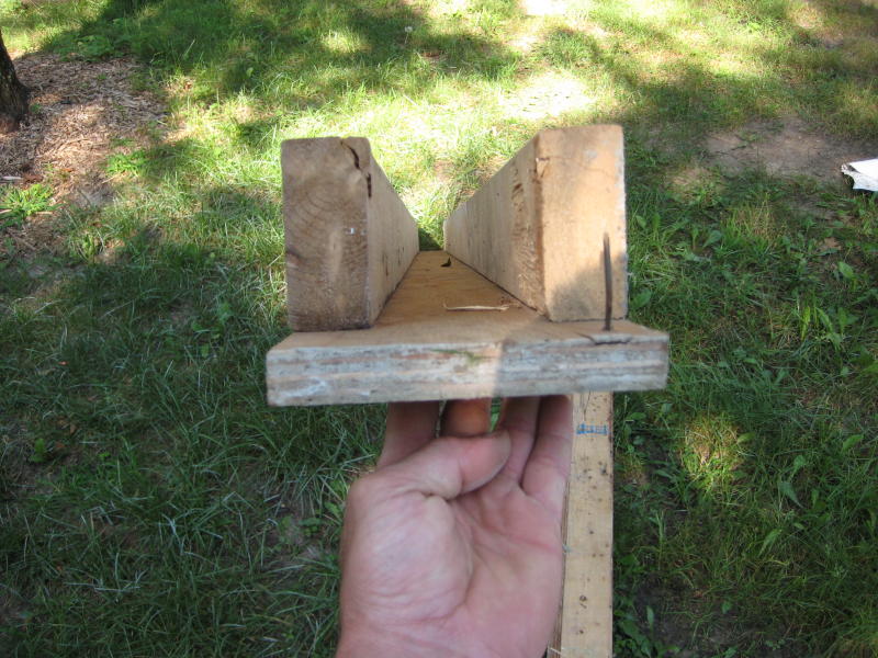

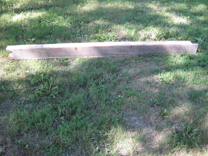

This is what my prep work looked like. 10x36 with a 4x26 strip along the side. For the forms I had some 4'x8'x3/4'' ply wood from work and cut it into 6'' rips and a 2x4's (from work) screwed to the backside top and bottom, and offset the ends 6'' so I can lap the ends. For stakes I used rebar from work. The one thing I would do different is drill holes through the 2x4 top and bottom so I could put the stakes there instead of on the outside. I have the forms and will post a pic later.

/ getting ready for a concrete pour
Much appreciated Hookblock.
Did you have to dig footings for frost? Looking forward to more pictures.:)
/ getting ready for a concrete pour #6
No footing just a slab on grade, 6x6'' mesh. This is an approach for the garage. Made a screed board with a notch on the end to rest on the garage floor so the approach is 1/2'' below the garage floor the other end is on the out side form. Followed that with a bull float, an edger between the form and the approach slab,and a broom finish. Next morning put a sealer on and saw cut, for a saw cut I used a 2x4 for a straight edge and a skill saw with a masonry blade set to 1/2'', with the concrete green= less dust. Hope this helps

/ getting ready for a concrete pour #7
Did you really pour concrete right on top of that grass & weeds?
/ getting ready for a concrete pour #8
I excavated 14" of sub soil and filled in (in lifts) a base of 6'' compacted gravel, vapor barrier, etc. with the 6" slab poured over that. 6" for heavier equipment.
