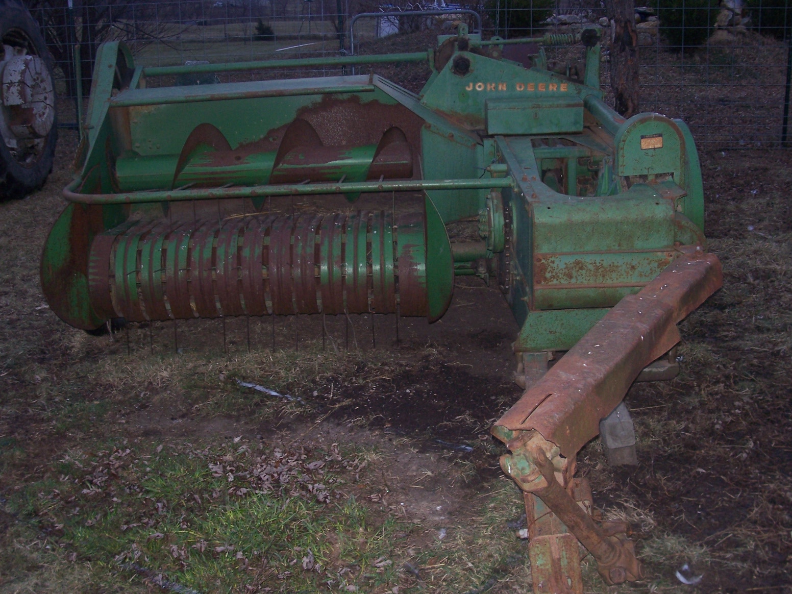

Hi. I am looking at getting into square baling. I dont know much about the balers and need some advice. I found a 214T that is kindof close to my area. John deere 214t square baler
I am looking to start out a little smaller and build up. This year I am wanting to put up about 20 acres of straw and maybe 300 bales of alfalfa (depending on the year and if we have enough for our cows) I may also buy some big rounds and put them through the baler and resell them. Any advise would be great. I have attached a couple more photos of this baler.

/ Getting in to small squares #3
I would look more for a 336 JD. Tons of them out and around for sale. Not to say this one is a bad unit, can not tell from 2 pictures. Look to see how thick (or thin) all off the metal is on the baler. Look at all sides of the bale chamber, that is where it would wear through 1st. Look at the axles, make sure they are straight and not bent or cracked. Look at the bottom of the knotter and the tips of the needles to see of it looks like anything has been hit or rubbing. Look at the area the plunger travels in to see if any grooves.

/ Getting in to small squares #4
Hard to tell from the pictures, but it looks pretty weathered and doesn't appear to have been used in a while. I'd pass on it. I just got rid of a IH-37 that was in much better shape for about the same amount. I got tired of the pain and suffering.

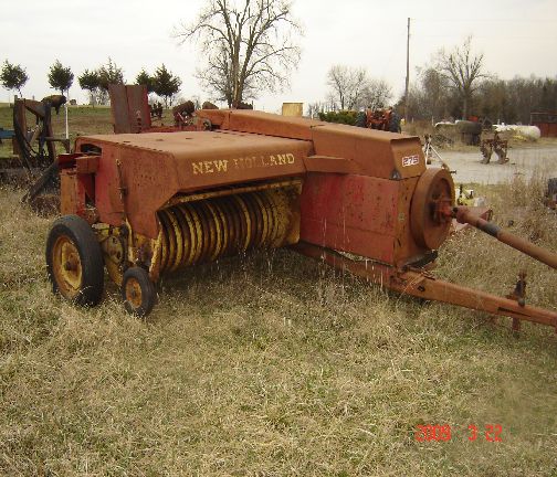

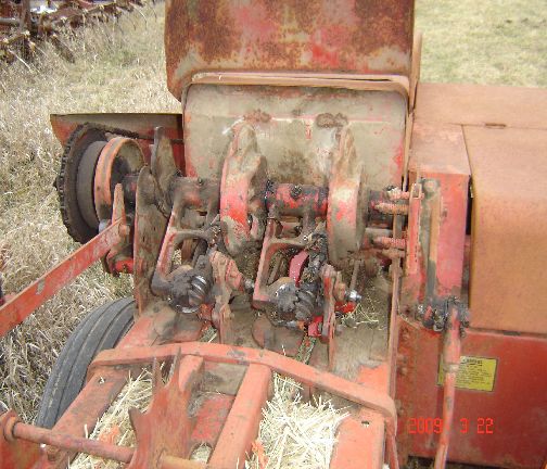

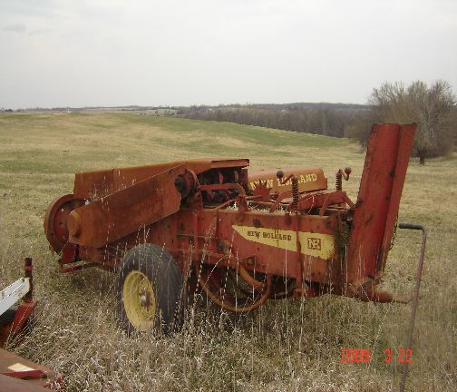

I agree. The 214T does look rough. The NH was sold but I have been on craigslist a little today and have got a few replies. One is a NH 275. It also looks a little rough though. The guy bought it not to long ago and said he went through the knotters and put new knives on it, but it has been outside.
I also found a JD 24T. The guy had bought it about 3 years ago and then it didnt sound like he used it or not very much if he did. Him and his partner just ended up using something else. He said that he had someone with him when he bought it that knew square balers and said that the knotters looked good and that it looked decent. He has kept it in the shed since. He figured if someone could use it he would get rid of it. I may get some pictures of it in a few days.
Thanks for the replies and keep the advise coming. Like I said, I am just looking to start out a little lower and build up once I get started. I've put up a lot of big rounds for the dairy cows but we havent done any of our own squares (we dont use many) but I would like to start doing some to sell.

/ Getting in to small squares #11
Ummm, hay still inside chamber... how long outside?:eek: Hopefully that 24T Looks better than the last two!!!! Shed stored, thats half the battle won there. I think new holland is hay implement king, but have heard of the older balers, some parts is no more for them. Cant verify that though. long time ago, 87' ish, I baled 1400 bales in a row with not one glitch with a 283 NH baler till the knot I tied the twine spools together busted:eek: Baled with a new 580 NH, large chamber, thats a hungry beast:D

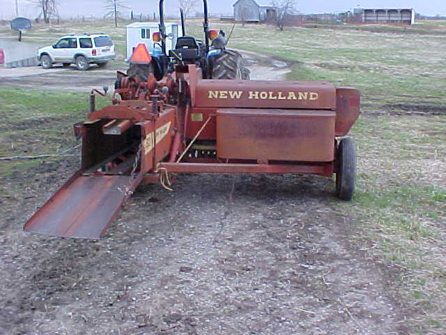

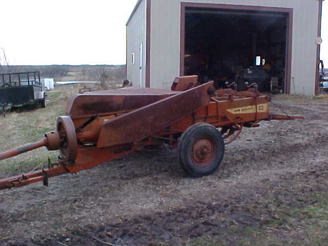

Hi guys. Thanks for all of your help thus far. Here is the newest option (not sure what I think yet but what are your opinions of it) Heres the email. It is a NH269
bought the baler Feb 1996, and have been baling about 400 bales every year except last year. Didn't have the time last year so I big baled everything with the used New Holland big baler I bought last March. After using the baler, I always clean it out and grease it so it's ready the next time I use it. I don't have a shed to store it in so it shows being outside. Since I've owned it I've replaced several of the pickup teeth, and the rods that drag the hay towards the chamber. I've got a spare belt and pickup teeth along with the owners book. If your like we can unroll some hay and run it though it. Main reason I'm selling it is due to the big baler I have now bales 1000lb bales and with an unroller, I can unroll what I need for those times I used square bales. I'd take $850.00 for it.
Thanks guys

/ Getting in to small squares #16
I think I'd go $850 on it, I stood on a wagon behind a 269 for several years growing up, rarely ever missed a tie and took a lot of punishment.

/ Getting in to small squares #18
Well, you know my feelings about old balers, but for $850 that 269 looks pretty good. It's weathered but the from the picture the chute doesn't look bad. I'd unroll a bale and see it work. You may have found a diamond in the rough! A '96 baler isn't that old and it doesn't sound like it's been worked very hard. Good Luck!
#20
How are the NH 269's to work on. For how this one looks in pictures (we'll see how everything looks up close and personal this weekend hopefully) I dont think I could pass it up for the price.
Also when looking at it what all do I need to pay close attention to . I know the bale chamber because thats where a lot of wear occurs, but what else do I need to look at specifically mechanical wise.
