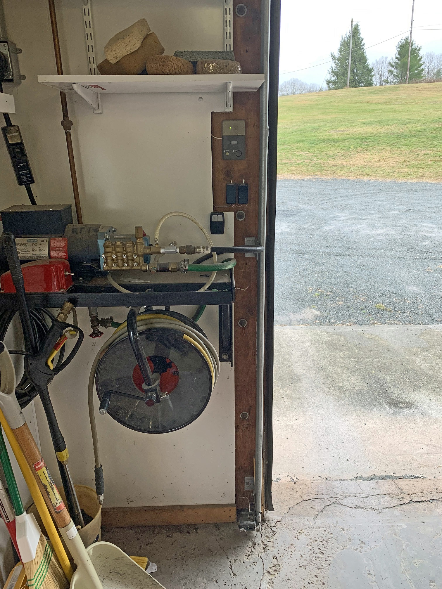

I just built a new shop and put a cement pad off to the side. I have a pressure washer right inside the door and it gets used to clean up the tractor prior to coming inside. Even with that I still have some mud that is difficult to remove and it falls off inside.
Luckily I put a drainage trench down the middle of the parking spot. Sweep the dirt into the drain trench then about every six months I remove the grates and wash out the trench. The drain goes into a dry well I installed for this purpose.
So far works for me. I agree the best way is to avoid working in the mud. However in my case I am frequently working around the periphery of a pond so its unavoidable.
