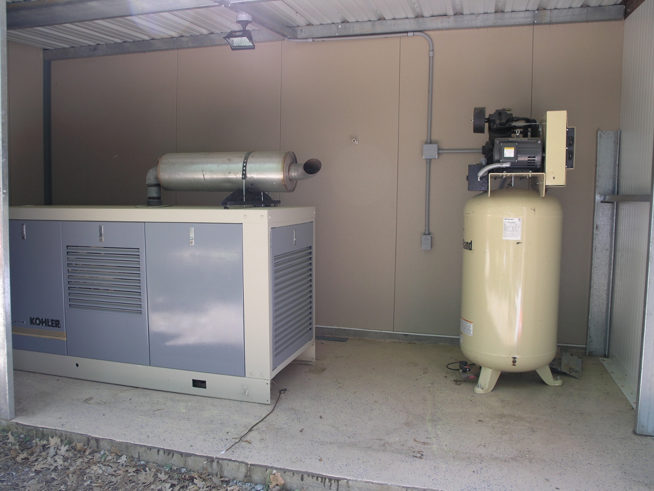

I picked up this beauty for $8k with 800 hrs on it. It does everthing for me, shop and house, 2 transfer switches, one 3ph for the shop and another for the house. It is a 50 kw 12 lead reconnectable. So it only runs 1800 rpm, I also installed a remote panel in the basement so I can check on it without going to the shop. It was an easy install as I did it myself when I was building the house and shop.
