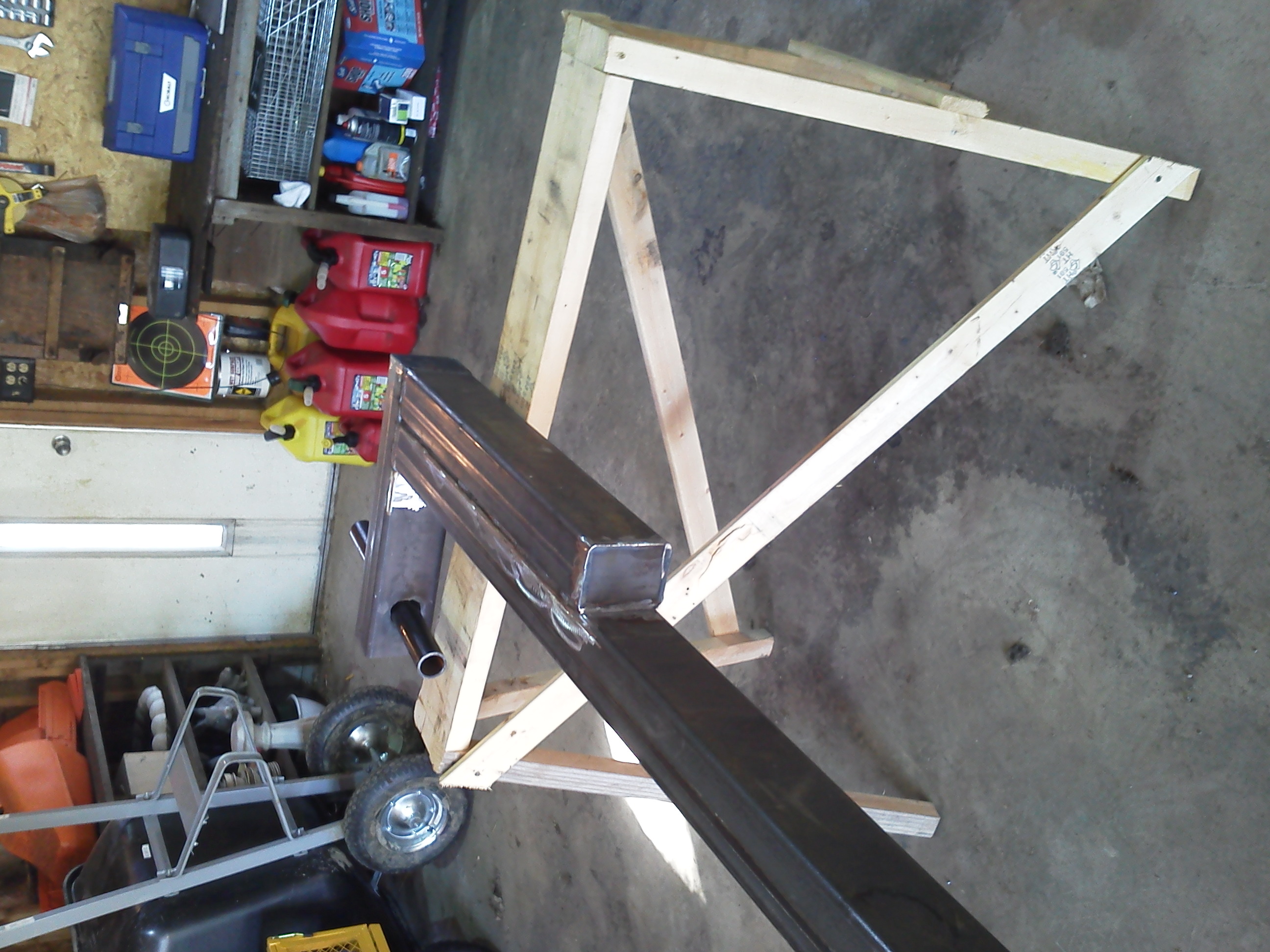

I am going to be putting in a 400' driveway on our property so I decided to build a carrier for the geotextile fabric. I was going to use 2x4, 3/16 wall square tube, except the supplier had some 4x3, 1/4 wall for half the price (called it surplus). I made the main beam 13' long, attached a 2' section along the backside at each end to help keep the arms from twisting. Then I took 18" pieces over to a friends and had him cut some holes with his plasma cutter for 1 1/4" sleeves. There will be a 1" pipe that will slide through one sleeve, the fabric roll, and then the other sleeve. Plan is to drill a 3/8 hole in each sleeve, then weld a 5/16" nut on as a retainer for the main pipe. As you can see I have not put in the sleeves yet. I need to get the 1" pipe first so I can make sure the sleeves line up before I weld them. Also welded on a Skid Steer plate so I can attach it to my loader. This is my first solo build so I hope it works out.

looks like it should work, and looks like your doing a nice job,
just a consideration,
I see in the back ground what looks like some gasoline cans, (not the best where one is welding), and setting on the floor like that sparks could case a major emergency,
I had a friend who lost a shop on a very similar set of circumstances,
   / Geotextile carrier #4
not jumping on you, some times things get sat down and nearly become permanent. out even considering what is a possibility,
If the friend had not lost his shop to a similar situation I most likely would not have even seen it,

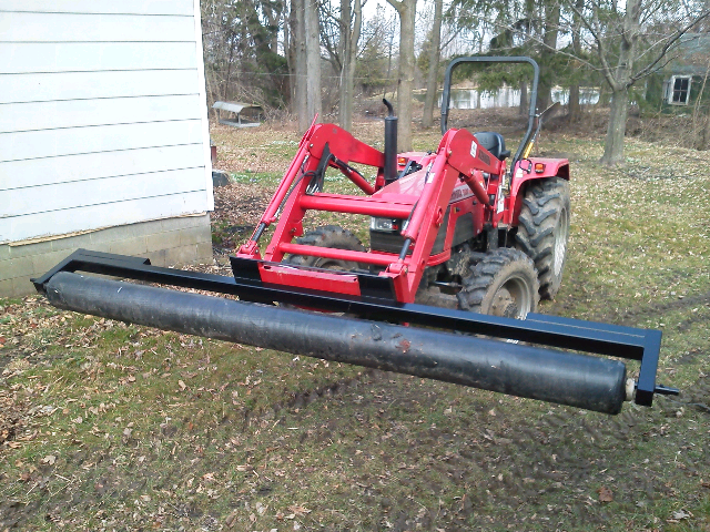

Here is the final product. I am pleased with the way it came out.

Skills! I like it, definitely going to beat rolling it manually.
The only thing I don't like is the thought of how much shipping is going to cost to get that sucker out here to do my driveway once you're done with it.
