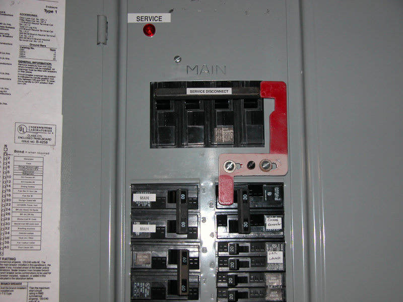

I have found if you don't need an automatic transfer switch, then the best solution is: Generator InterLock Kit
You just need to add a breaker and this kit and you can power your entire panel. Safe and easy.
here is my panel:
paul
here is my panel:
paul

Well the picture is my own version, based on those available for purchase. Of course it is best to show the commercial product that is UL approved. For many people it is not worth the time to do a DIY. The price is a bit high, but much lower than the other transfer switches discussed.
Paul

I dislike those small generator subpanels. They only allow a few circuits to be transfered. Much better is the interlock kit. I replaced my whole house panel with a generator panel that has a version of the interlock built into the cover. Great idea.
It is nice to have all circuits powered up during an outage. I can walk into the bathroom and flip the switch on and there is light. Just like normal. Bad part is that you don't know when the line power is back on.
   / Generator Transfer Switch Question #9
I solved that problem with a small pilot light on the panel (looking at my panel's picture). It is a neon light (1/25 watt) mounted on an insulator with a spring contact to touch the main lug on the main breaker. Small fuse for protection in wired-in. The light will always show utility power no matter the position of the main breaker. Only thing is I need to occasionally go to the basement to check the indicator light.
paul
