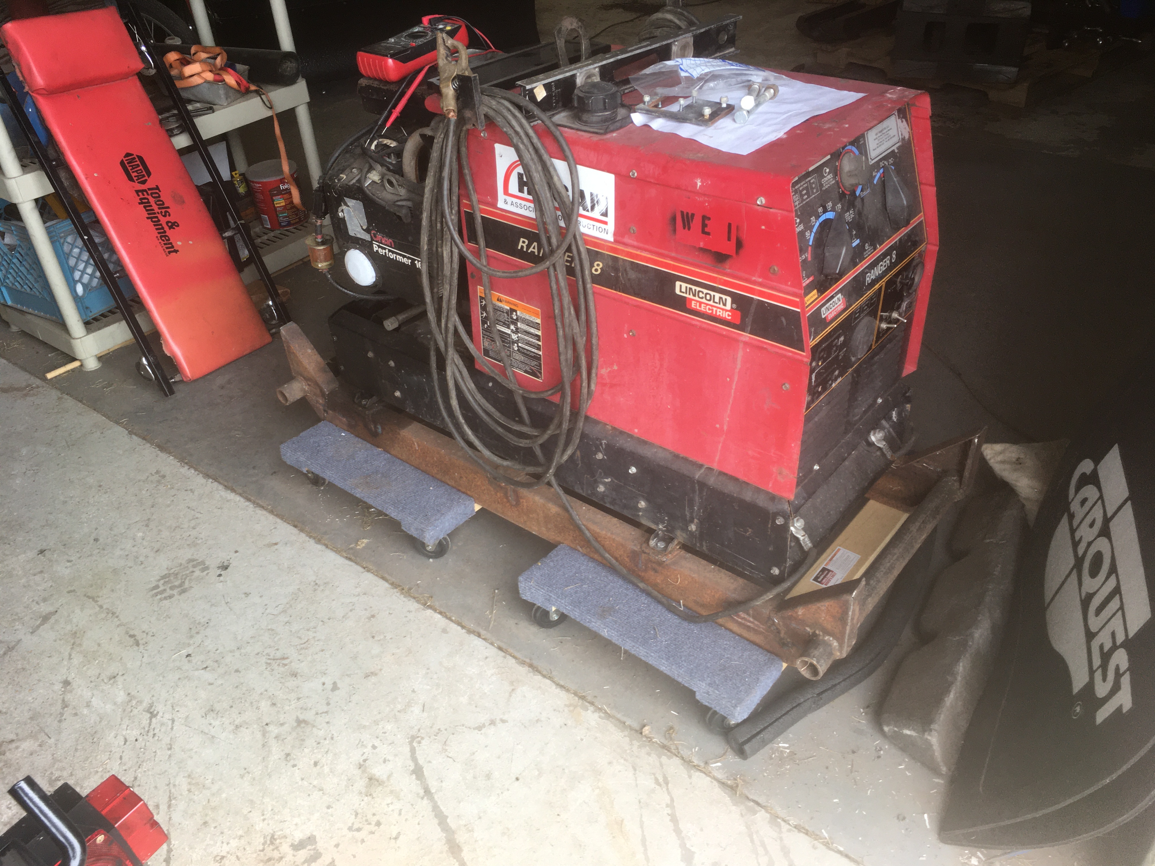

As was mentioned, try it first to see if moving is a problem.
I put my welder on HF dollies, it stays put.

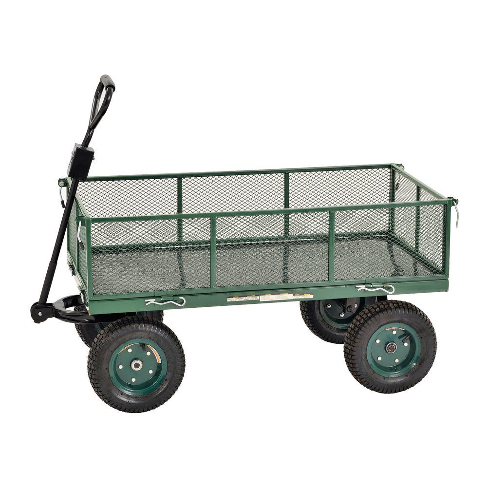

   / Generator too heavy for my dad. #14
