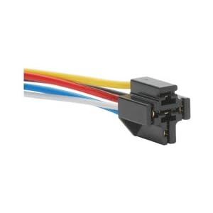

I put one of these on mine
Auto Roll 2 Channel RF Remote Control
along with 2 automotive relays
Amazon.com: 12 VDC Automotive Relay SPDT 30/40A: Electronics
Amazon.com: 12 VDC 5-PIN RELAY SOCKET: Electronics
Amazon.com: In-line ACT Water-resistant Fuse Holder - 10 AWG: Electronics
Use the relays to isolate the generator from the board it cant take the current of the starting solenoid and the second one to ground out the the coil to stop it if its a magneto.
