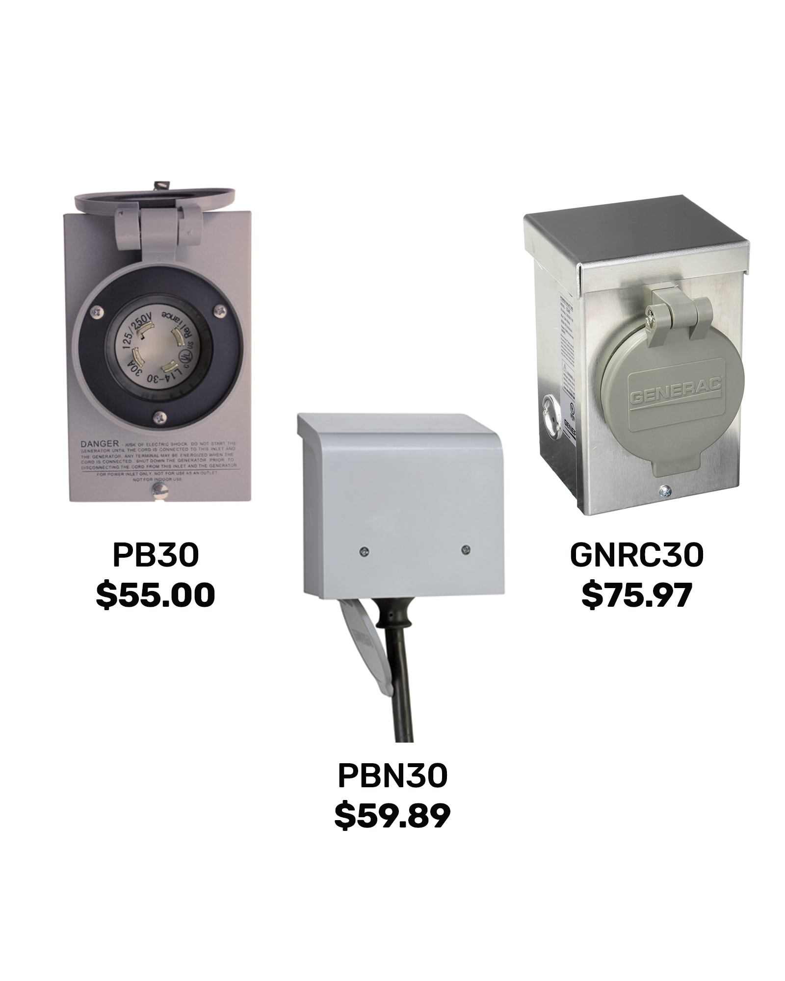

So I decided I am going to get a manual transfer switch and put yet another plug outside.

Your first post said LOTO, not interlock. Big difference. Good idea to get the plug for outside and the proper cord end. Then you won't have a suicide cord.

I do this for a living…and im still alive. Would not be if i fed a house the way you want to.
go here. Generator Interlock Kits | Electrician Interlock Kits | GenInterlock
chose an interlock that works with your panel. Run a dedicated generator interlock outlet OUTDOORS and feed it with 4 wire, 10/3 romex with ground , for 30 amp generator. The generator HAS to have a 4 wire, 240 outlet.
use anproper generator inlet receptacle so you dont use a suicide cord.
the interlock absolutely prevents backfeeding, plus you can access entire panel
