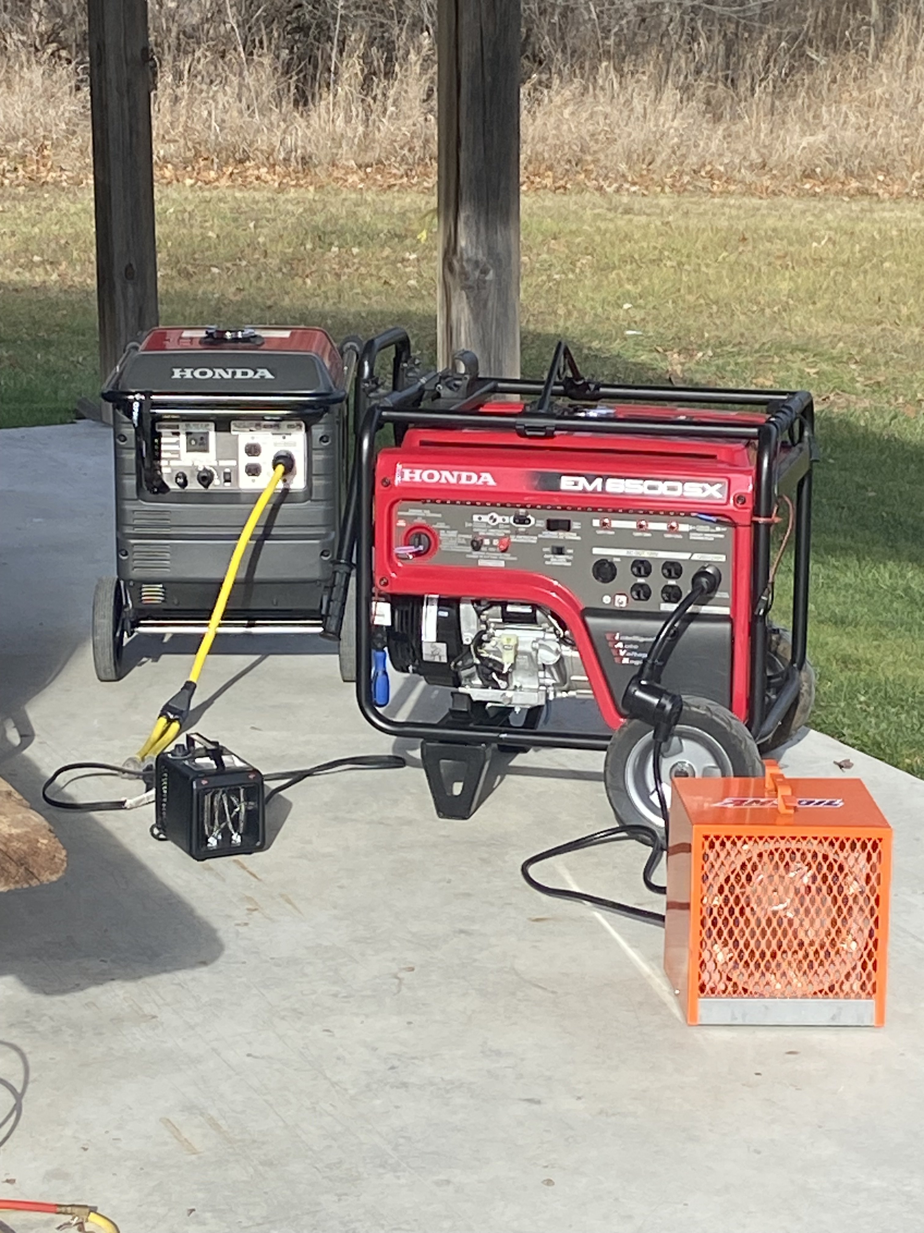

I have a portable Honda EM6500SX and I run it monthly for about 30 minutes with a 4500 watt shop heater plugged into it. This load is about 2/3rds of its maximum. Is this too hard on it? It gives a nice grunt when I turn it on, after a warmup, and handles it well without any sense of straining.
I've maintained those specific models on constrution sites for years, putting 4 to 5 thousand hours on the 6500sx models and never having problem with surging loads. We would load them up to 5,000 watts, but typically ran them in the 3,500 to 4,500 watt range. They are a quality unit.
whats your oil change interval? and typical failure point at the 5k hours
Makes you realize how we over baby our engines in general, fussing about oils, and which oil filter brand is good enough for our pampered engines every 150 hours, and here’s simple splash lubrication with no filter at all, going 5,000 hours. 😀
The oil was changed every week or 50 hours of operation (typ weekly hours was a minimum of 30), whichever came first. Total hours were recorded daily and the hour interval was strictly adhered to. Valve adjusment checked every 200 hrs. (Edit: or once per month.)
Typical failure to place out of service was when oil blowby was present in the exhaust, caused by scoring on the cylinder walls.
I believe the early failure was due to employee laziness, not rinsing off all the metal particles on the magnetic drain plugs and not running a small amount of oil through the engine to purge the particulates at oil change.
how did the valve adjustment go? was it initially off? and slowly not needed to be adjusted or was it constantly needing an adjustment its entire life?
and this was an average across all the generators? how many made it to these numbers on average. did hp size or engine design play a factor in longevity?
The small engine mechanic did all the mechanical maintenance, so I don't know the answer to how the valve adjustments went.
Better than 80% of the 6500 watt generators made it to the 16 month repurchase change out. About 275 hours per month runtime per unit on average.
Not an engine mechanic, so I don't know about your last question, they had a honda 390 engine in them and were over head valve if I recall correctly.
