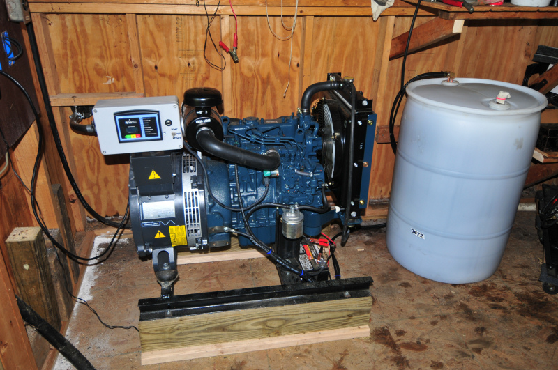

I have my genset in my shed, which is about 30' from the house (50' from the point of power entrance) I have remote start, and a manual transfer in the panel box. It is nice. Noise is not too close, and I store 50 gal of fuel there. I will give you my opinion. I had several (always increasingly bigger) generators. They were gas powered, which caused some issues if you don't use them for a while, the gas starts to degrade. After I got my Kubota tractor, I had little use for gas (except week wacker, blower and chainsaw) so keeping good gas was more of an issue. I finally traded up to a diesel powered unit, 7.5 KW with a Deutz aircooled engine. After a few years I upgraded again. I decided to get a Kubota engine powered for some commonality of filters, etc. I got a 10KW. Very nice unit. 1800 rpm and water cooled makes a quieter running setup. This is the one I got: Kubota 9,875 Watt Diesel Generator
I decided against an automatic transfer, since when we are not home I did not want it running if not needed. You can go with one of these: Manual Transfer Switch Kits | Generator Interlock Kit for about 10% of the price for an auto transfer switch.
It is not used often, but when needed I cam run the whole house, 2 fridges, freezer, 2 heat pumps, lights, TV etc. I automatically switch off the electric HW heater when the gen runs, but I have an override switch. On long outages I shut off most big users, turn on the HW heater and charge it up, which will generally last 1 day. Also we do not use the electric stove or dryer, but no big deal. I am very happy with the setup. Diesel can be stored for decades, and on an outage I can start and transfer power from the house. You will pay more for the diesel unit, but it is a great choice.

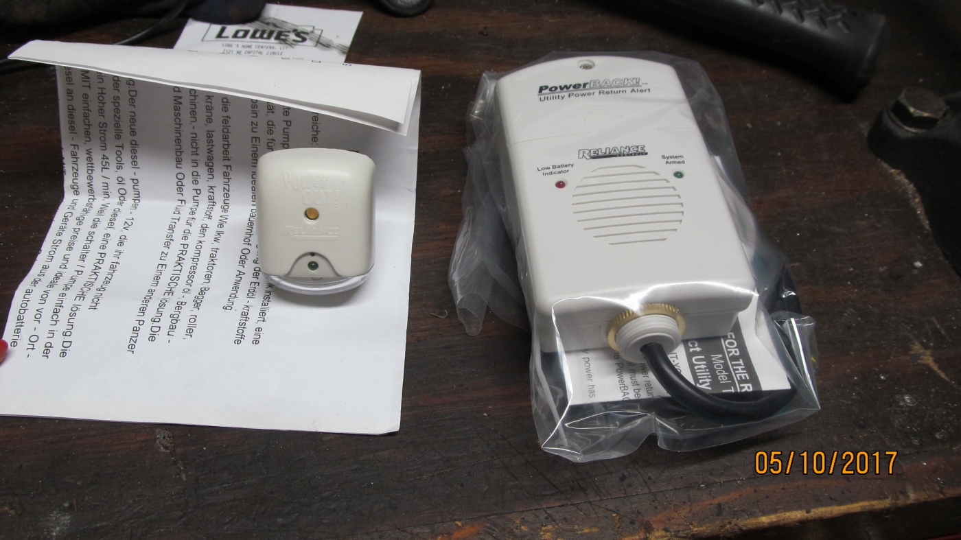

Mine sits under an open shed behind the house. Diesel is the way to go. If you are handy and don't mind taking some time and taking a chance the military surplus MEP-803A is a good choice. Some of the government auction sites get a little crazy but sometimes you can find a deal on one. I ended up getting mine for under $1200 but I'm right at 2 grand for everything all wired in.
I also installed a breaker interlock made by the same MFG as my panel.
I also used the power out and power back alarms from Reliance Controls.
