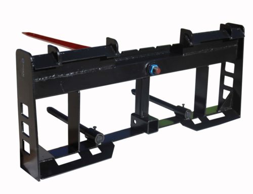

Dad & I ended up agreeing on & buying this model.
Titan Skid Steer 36" Pallet Fork 49" Hay Bale Spear Trailer Hitch Attachment
At the time Titan was putting one up for No Reserve Auction (instead of Buy it Now) about every 3-4 weeks or so and generally the interest / bidding fell off at about the $350 - 375 mark. Don't know if they are still doing this (there wasn't one up when I looked just now) but if you're not in a rush it might not hurt to keep an eye on e-bay.
Also - you mentioned "occasional grubbing". Our loader is rated at roughly 1100 lbs so we're pretty close to you there. We opted for the 36" forks because longer forks will actually reduce the prying force you can generate at the tip due to the increase in leverage you give the object being moved.
Food for thought if all your other tasks don't really require the longer forks.

Good deal. :thumbsup:
It would be easy to add to that frame so it would work on the three point also.
   / General advice for buying tractor forks #27
That's exactly what I was thinking :thumbsup:
and then that would be a perfectly good reason to add the rear remotes and do a T-n-T kit. :cool2: (My father hates me being on these forums LOL)
The second option was to just make a simple 3-pt A-Frame to put the spear on.
My biggest problem is that Dad is a much better welder than I am and I can't get him home and out of the RV long enough to fab anything (Being retired must be nice).
Guess I'm just going to have to keep practicing. :laughing:
