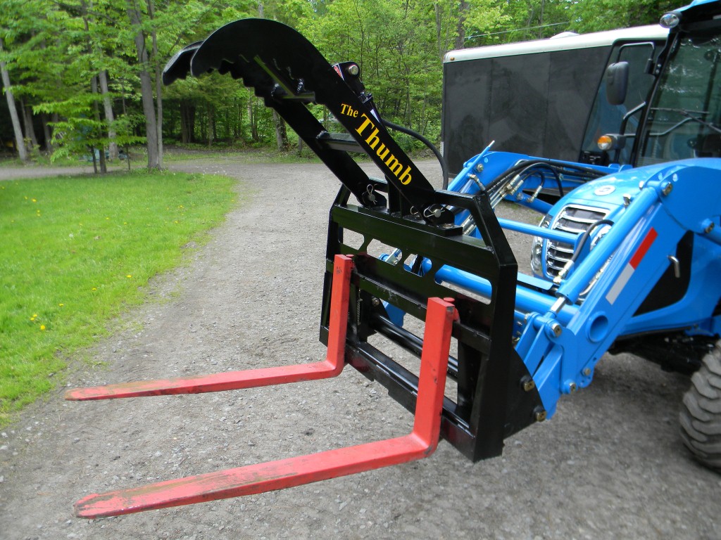

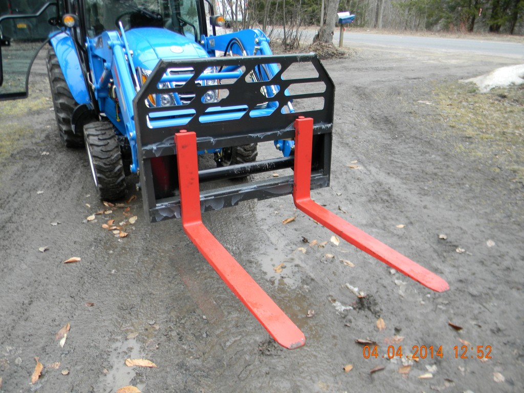

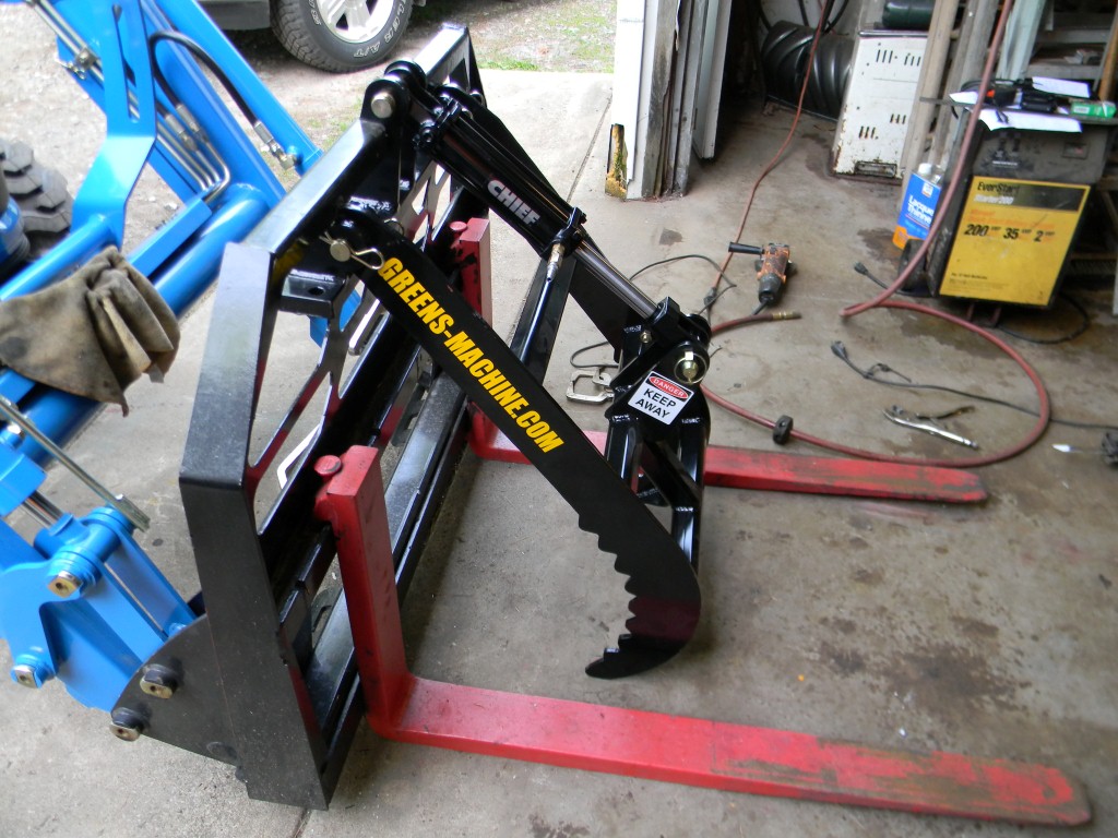

My forks are regular SSQA forks. Bought them at a surplus SS equipment shop. Its been a few years but I think they said the forks are rated for 4K. My loader is rated for about a ton. That is way more than I needed but the price was right. New they were about $500.
The forks are adjustable so they can slide narrow or wider by lifting the locking latch and sliding the forks. 48" length is standard but you can get longer or shorter forks. 48" is a good choice for tractor use in my opinion.
I modified mine to accept a hydraulic thumb and welded in a few extra braces. (before and after pics)
