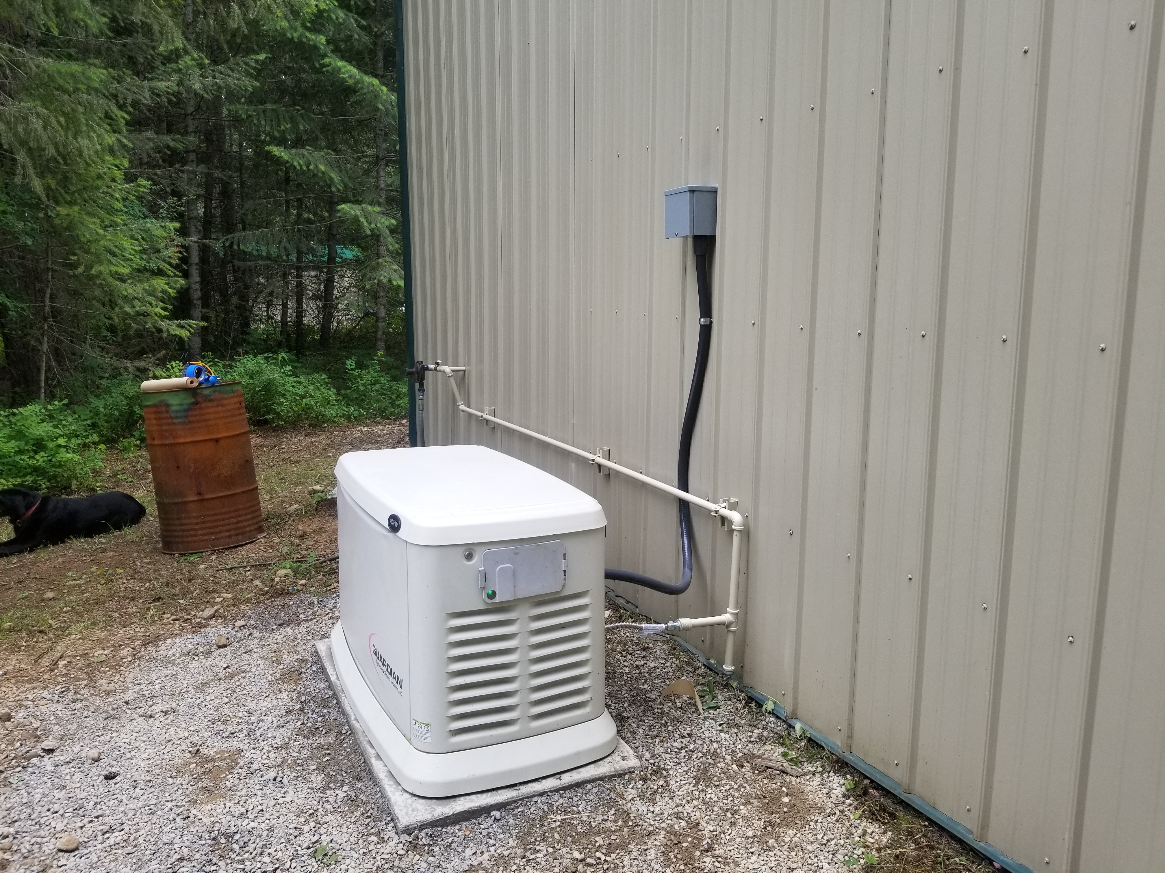

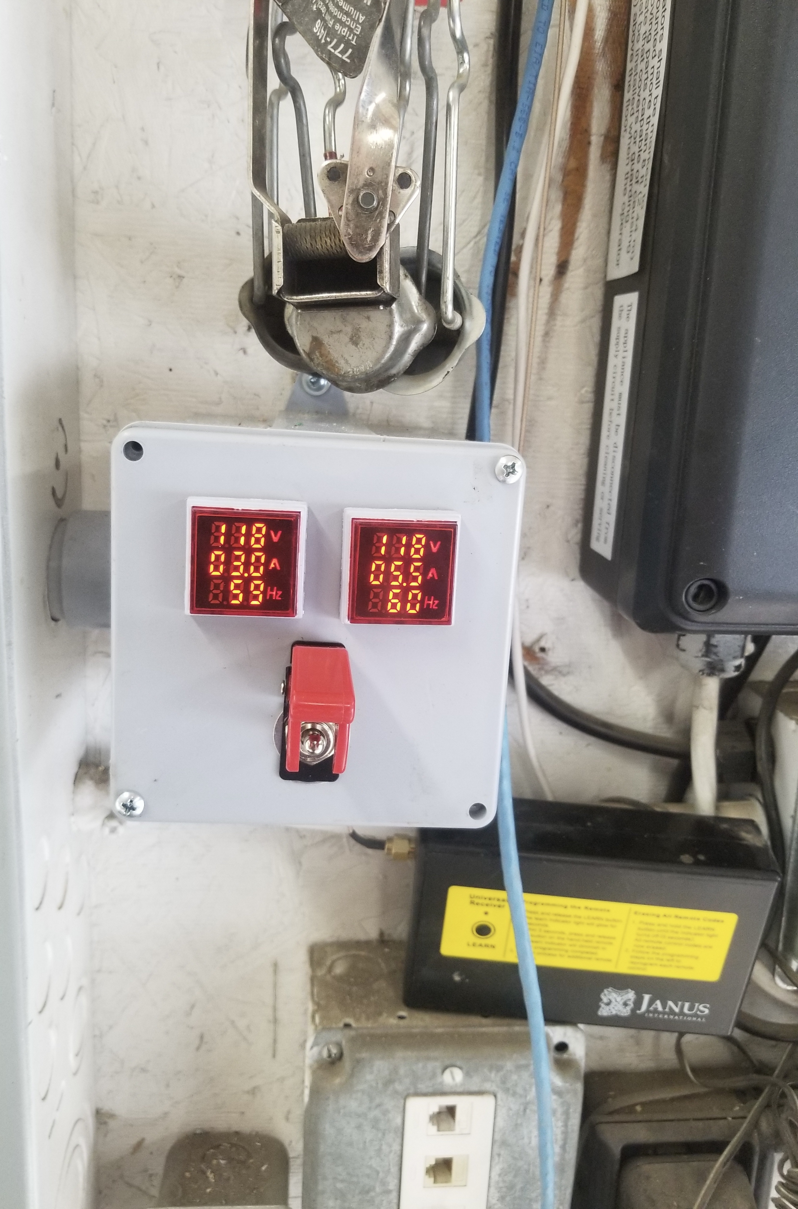

I installed the resurrected 10 kw for manual start in my shop, so i can control roll up doors and lights during an outage ( thats when i get my calls alot of the times).
I built my own manual start/stop switch with 2 digital displays for output. Have manual transfer switch for panel. This unit is large enough to power air compressor also, if i need to top of tires.
On the generac units, after 2008, you can switch out the controller to operate on 2 wire start instead of auto utility drop out. This way it still exercises automatically.
