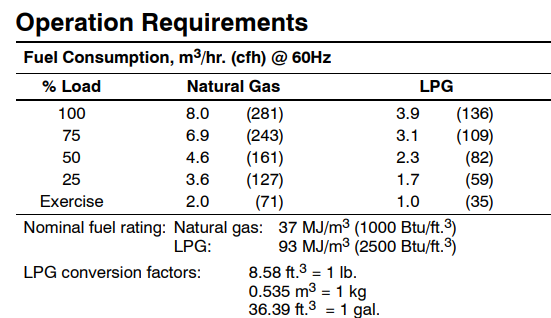

Any one have any experience with the LPG ornatural gas fuel consumption of a Generac generator when operating at low loads (25% or less of rated?
The specs from generac only provide consuption estimates at full losd and 50% load.

So this is from a Kohler 20KW (they provide this in the spec sheet), not a Generac, but the relative amount should be similar.
As in, the difference ratio between 50% load and 25% load in the Kohler is likely to be pretty similar to the ratio of the Generac.
As you likely already understand, in order to provide a 60Hz frequency, these generators are run a specific RPM, regardless of the load; an engine will have a "sweet spot" of power generated at that RPM, and looking at the above consumption chart that sweet spot is likely 100% load - so at very low load you're using a lot more gas per watt.
(nb The ratios will vary somewhat because it's likely that the generators of a given manufacturer may share engines in a different state of tune for different KW targets but in general the fuel consumption will follow a similar curve, +/- a bit)

Too many letters and numbers for me to convert.
Do I understand on the LPG chart that it would use 2.3 gallons per day at 50%? Trying to understand how long my 500 gallon tank might last.
Thanks.
   / Generac Generator LPG or Natural Gas Fuel Consumption at Low Loads #6
Thanks.
That's 2.3 gallons per hour, not per day.
Thanks.
Ok, a few things go into this.
1) your 500 gallon tank has a maximum of 400gallons in it.
2) as the tank gets empty, it cools off and the last portion may not be accessible because it can't boil off. (Better in the summertime, much worse in the winter time.) There are tables to look this up in most manuals.
3) as @drumminj points out, that is 2.3gal/hr
4) 2.3gal/hr assumes that you don't load it up to full load, in which case, you probably want a smaller generator. Ideally, one that can run 80% load much of the time.
Bottom line: probably not more than four or five days, as little as two and a half, and up to seven or so depending on outside temperatures, and actual loads.
If you anticipate mostly small loads, and occasional large loads, a better solution might be to have batteries that can be recharged by the generator quickly, and run the small house loads for an extended period of time. That's likely to be the most fuel efficient solution.
All the best,
Peter
