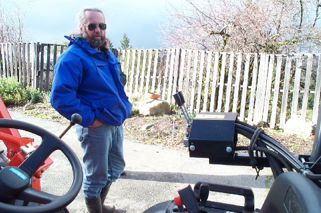

Here are the promised pix of the Gearmore T&T kit. First picture is taken from the left side of the 'bota shooting across. Funny looking guy is me.

This next one shows the T&T spools from the top. Lettering did not come out too well, but the decal indicates which spool goes which way.
   / Gearmore T&T photos
This one is again from the left side. It shows the bottom of the T&T bracket mounted to the right side of the ROPS. You can see the three supply lines heading toward the front of the tractor, and the four control lines going to the cylinders on the 3PH.
The large line goes to the "out" of the FEL joystick. Second one goes to the return (I'm guessing here). I have no clue where the 3rd one goes, but I will find out!
Here's the last one. It is taken from the back of the tractor, and shows the T&T cylinders, and the 4 hoses running up to the T&T spools on the right.

It tops (actually tips) and tilts the 3-point hitch. /w3tcompact/icons/smile.gif What would normally be done by manually adjusting the top link can be done with the 'top' aspect of a TNT. The tilt is simply tilting the 3-point hitch up/down on either side... adds plenty of versatility to an implement if it can be tilted. So the end ability you gain with a TNT kit is instead of only up/down movement, you have up/down, tilt and tip ability (which angles an implement in toward or away from the tractor). Very useful... I think most owners would like to have one, but they are sometimes pricey.
