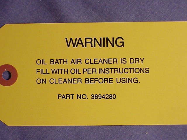

dealer should have filled it, or it should have been tagged as empty. i cringe just thinking about a gear box empty for that long.didn't it make any noise?
   / gear oil put in by whom? #20
I agree.... Something like this should have been attached....
