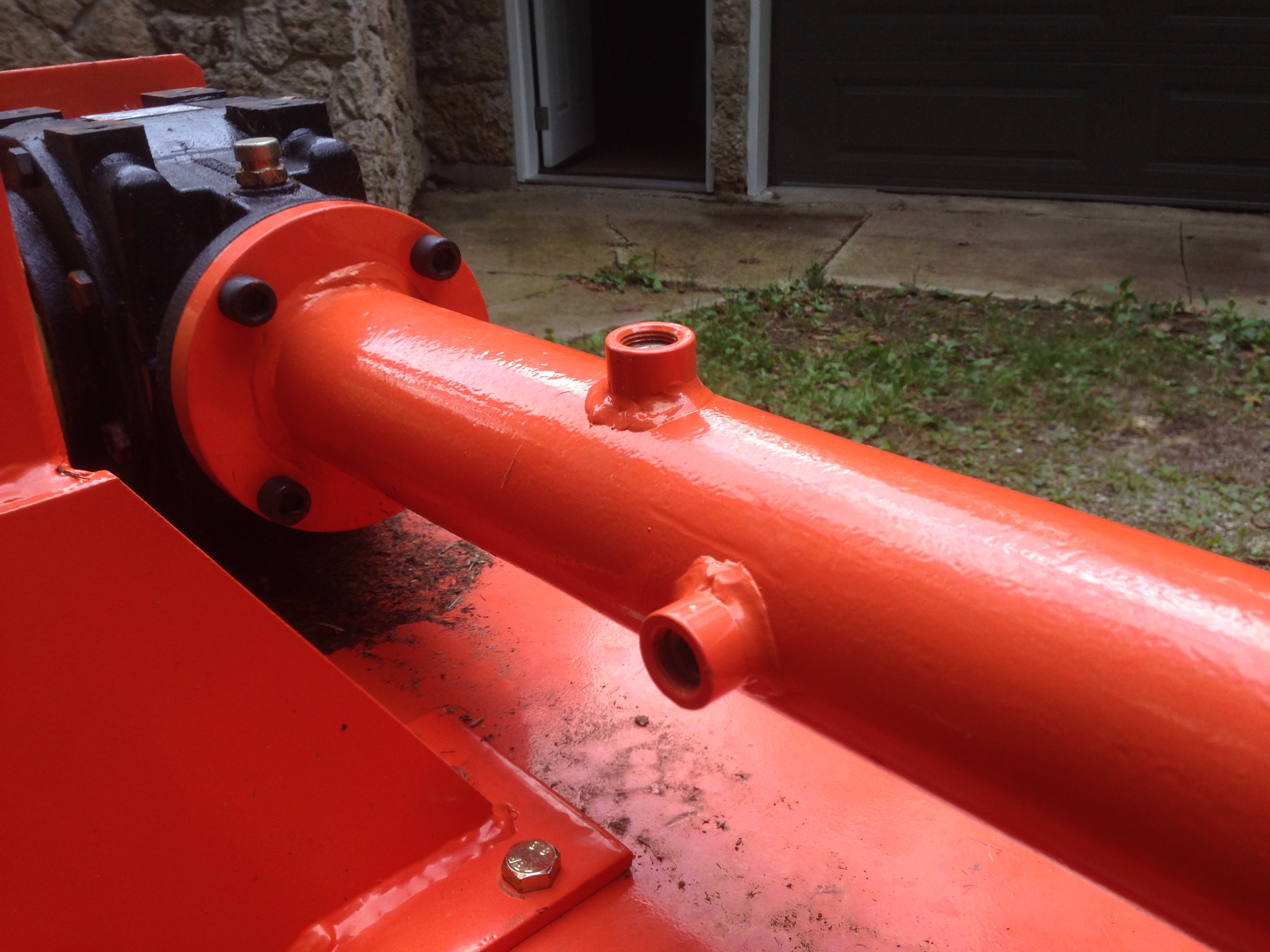

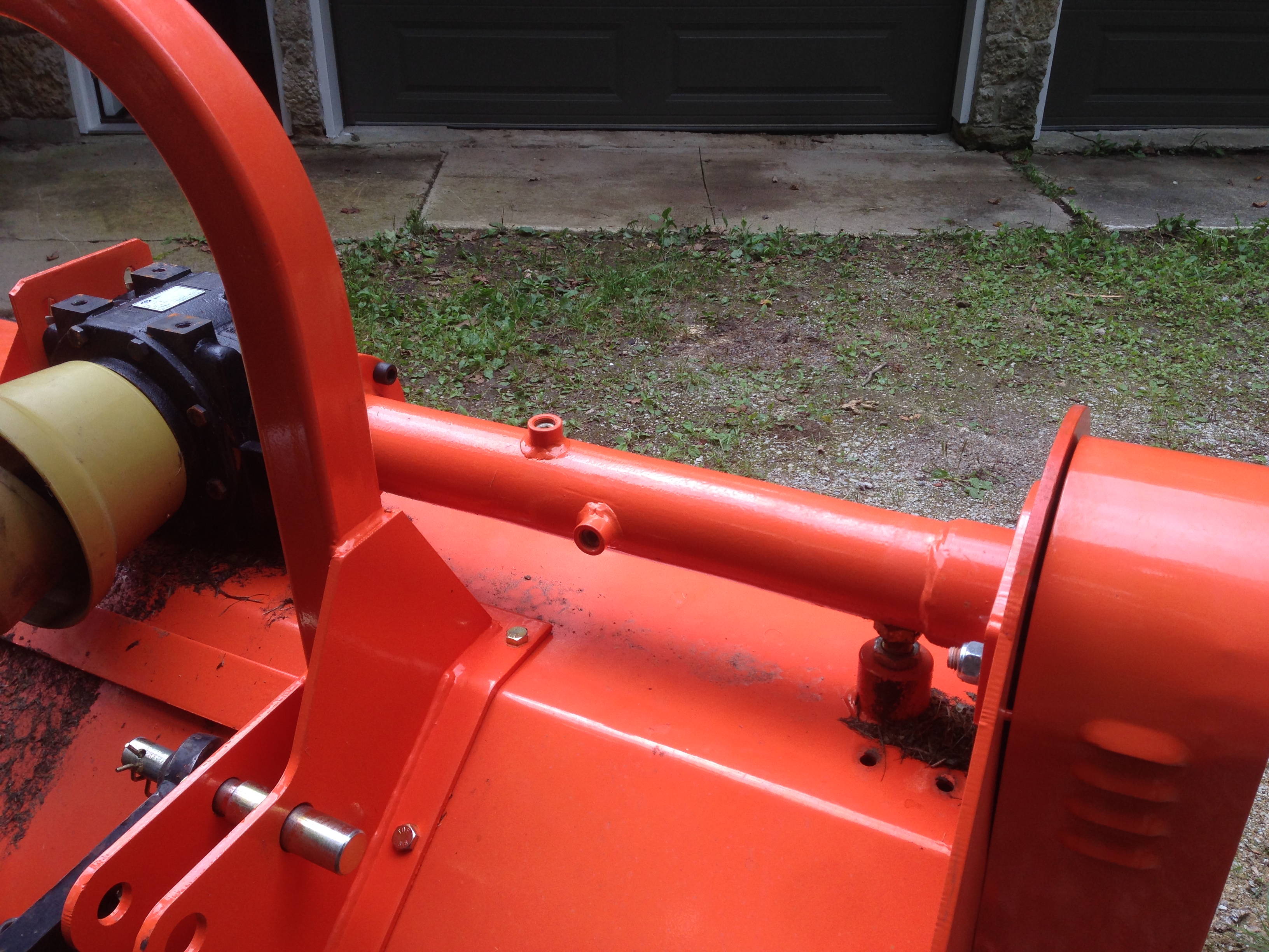

Hello,
I filled my gearbox with 80W90 with no problems (filled until it dripped from sight plug). My question is about the two plugs on the shaft that comes from the side of the gearbox to the belt. There is a plug on the top and one on the side. Is there suppose to be gear oil in the shaft as well? There was nothing in the instruction manual, but it was extremely under detailed to begin with. :confused:

Some flail mowers use oil in that shaft housing. It's used to lubricate the top belt drive bearing. I think the Chinese flails like this one often do. Check with the seller.
/ Gear oil on flail mower. #4
I concur with Eric. My New Holland 918 has similar plugs on the cross shaft which lubricates the pulley end bearing. I don't think you will see a zerk at that bearing. I wonder about that arrangement though, after doing miles of road side ditch with right side tires in the ditch.

I think this is a Chinese flail mower. These 2 oil plug are used to fulfill and take out oil in this shaft tube. But for the upper plug, it seems that it cannot let air come out, not good, I already changed that plug to let air come out, because it will be hot inside when working, so the pressure inside could be high because of heat. I usually suggest customer to fulfill half oil into this shaft tube.
I find the bolt and nut which fix the 3 point hitch, you should install the bolt from inside to outside, mount the nut on the outside. You mounted the nut inside, so it will stuck some grass on the bolt end, and damage the bolt soon, you will meet trouble if you want to disassemble it in future.
I see 2 hole near the side wall, what's that? Do you drill it?
