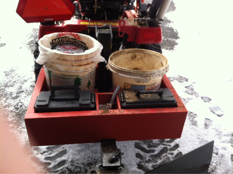

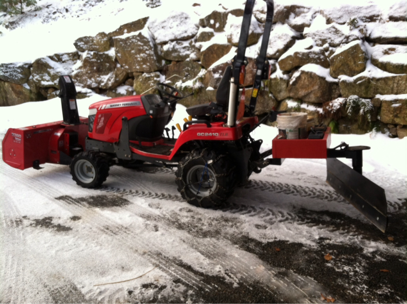

First, I have a 400' paved driveway that's very steep and never intended to be a winter home so we leave for much of the winter. I also maintain about 1500' of the private gravel road that leads up to our drive and early snowfalls were an issue with the blower snagging stones and going through at least 5 shear pins each storm and because of the incline, I wasn't able to allow it to freeze and pack down the gravel area like others do. Two years ago I went to TSC and grabbed a 5' rear blade that I now use for dragging the snow and ice off the gravel and scrape the paved drive if it's just an inch or two of snow or ice mix.
I do have chains on the rears. I left the hoe in for the first season but it was too much of a counterweight and didn't allow for good steering traction so I built a rear ballast barrel which worked well for a few seasons.
I do garage my scut that's heated to 45° as well as diesel stabil treat my fuel.
I also added the rear bucket/supplies holder that helps me have sand as needed and adds weight to the blade.
Sand buckets.....fill 4 of them with sand/salt in Nov and resupply small 5gal. buckets when away from bigger supply kept at house. Then blow off drive in the Spring. Enjoy the summer and then repeat. ;)
