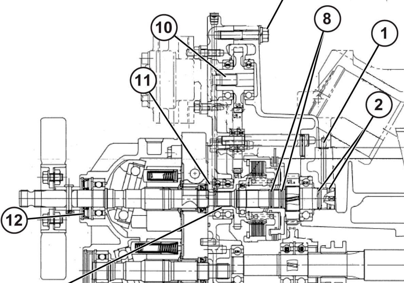

Just throwing out a weird idea to see if it sticks: perhaps it has something to do with the PTO clutch; perhaps it is leaking. The PTO clutch is a series of wet plates that are engaged hydraulically.
In this screen print from the later service manual, the clutch pack is just to the left (forward) of the arrows from the 8 balloon. Those arrows are pointing to two O-rings that run on the shaft. Further aft, behind the gear and the bearing are two more O-rings (balloon 2). Hydraulic oil is injected through the passageway by balloon 1 into the hollow shaft between the aft O-rings, through the shaft, and exits the shaft between the forward O-rings.

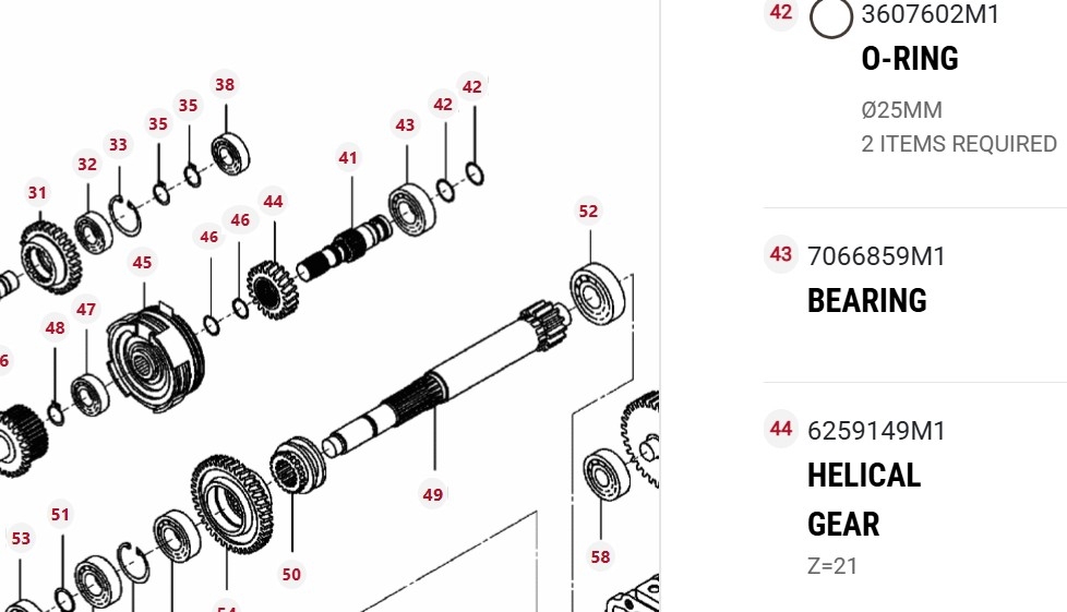

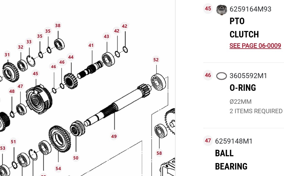

Two more screen prints from the later parts manual. The PTO clutch pack is #45, the forward O-rings are #46, the shaft is #41, and the aft O-rings are #42.
Massey Ferguson GC PTO clutch pack & seals 2.jpgMassey Ferguson GC PTO clutch pack & seals 3.jpg
Try "pseudo-mowing": driving it around with the mower raised and the PTO not engaged and see if it still whines and foams.
View attachment 3595348View attachment 3595349
Hope it's not the PTO clutch. That is above my pay grade.
