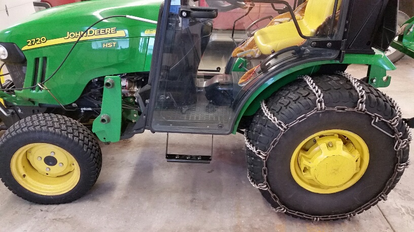

I added this step to my 2720. I ordered it from my JD dealer. Part number LVU18332.

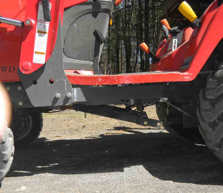

   / GC2410 Step pictures or ideas?
PM me a dimensioned photo of the entry area. I've got an idea. ;)
Hopefully I've figured out how to attach a photo here. PM doesn't seem to allow it at all.
The top of the cab floor is 19.5" from ground. While the cab floor is pretty solid, it's not good enough to hang a fixed step from.
The horizontal grey bar with the two heavy bolts (attaching it to the vertical fixed portion of FEL arm) under the cab floor has 15" clearance from ground.
This bar is very beefy (something like 3/4"x3"), and could serve as a mount point.
The mower deck attachment lever has 9 1/2" clearance from ground.
From the rightmost of the two big bolts, to the beginning of the fender is 20". Looking straight down, the tires extend about 3" farther from the center line than the cab floor. This is important, because we need to keep the overall width as close to what it is now as possible.
She would very much like two steps, making the step height about 6.5". Which would put the top of the step 3" lower than the mower deck attachment point.
It is very unlikely we'll ever put a belly mower on this machine. We have a lawn tractor for mowing.
That's clearly too low for a fixed step.
