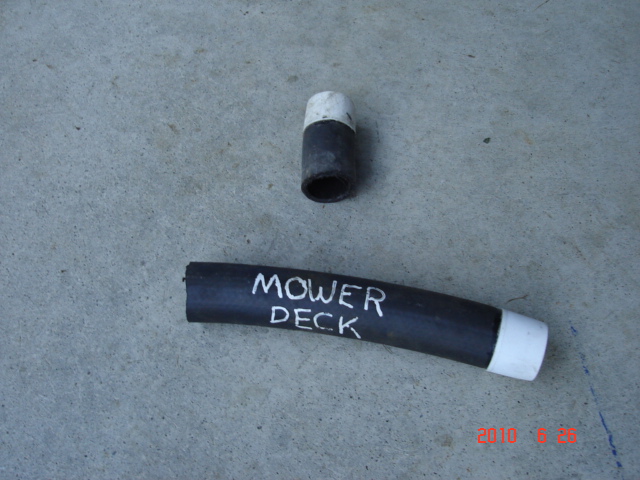

The 2300's came with a rear cover, but no mid-PTO cover. I too puzzled about the manual... it does seem like a good idea to cover it when doing dirty things....
I found that 1" heater hose will just slip over the splined shaft. Glue on some sort of cap, and you're good to go. I also use the same deal on the MMM and snowblower shafts when they're stored.

Great idea:thumbsup:, front pto was uncovered last winter but i will make sure I cover it up for next winter.:D
The picture looks more like a "mower dick".:laughing:
