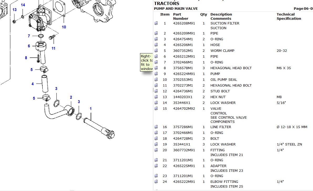

Thanks for the replies! Wondering: where is this extra "hydraulic screen?" Is this the item that one finds in the manual after "remove left rear wheel..", and called "suction filter?" Also, I will be sure to check the blades on the hydro cooling fan.

I notice that in the manual, "Transmission Suction Filter" section, it mentions "apply sealant to threads on drain plug(s)" and I was also wondering what type of sealant people are using in this instance?

I don't use a sealant. My gc1710 has a rubber O ring that seals the suction filter once tightened down.
/ GC2410 Hydraulic Shudder, etc #9
Suction filter has 2 O-rings, don't forget to re install afterwards. Do not over-tighten. The plastic will crack, or o-rings deform.
The drain plug on the transmission housing does not appear to have an o-ring.Any pipe thread resistant to oil/hydraulic fluid should do.(Permatexョ Thread Sealant with PTFE as an example). Teflon tape should be avoided, but better than nothing.
