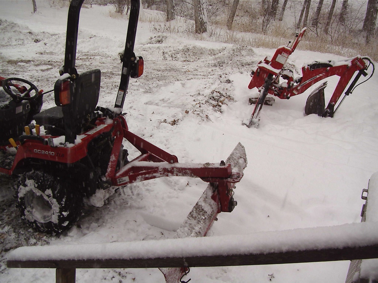

   / GC2400 rear blade #12
I run a 4' box blade and a 5' woods RBC. Box blade I can pull with 4 rippers on their highest setting (least depth) or 2 all the way down and 2 high which also works pretty well. I have trouble with clearance on the back blade and it catches sometimes. Only other issue is that when running with alot of cutting angle and the blade angled it will cause the tractor to turn- some dirt in the bucket usually takes car eof that proble.

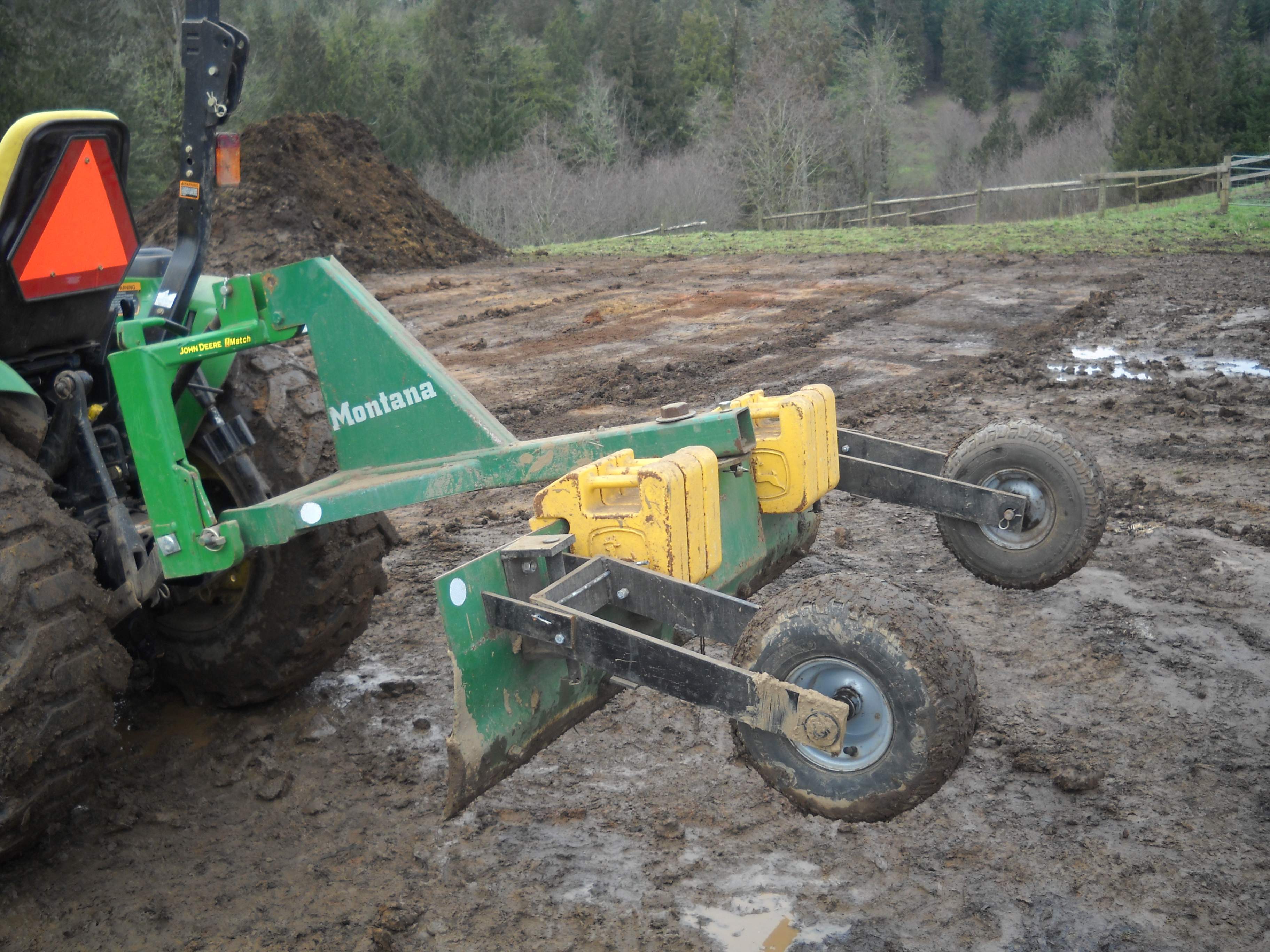

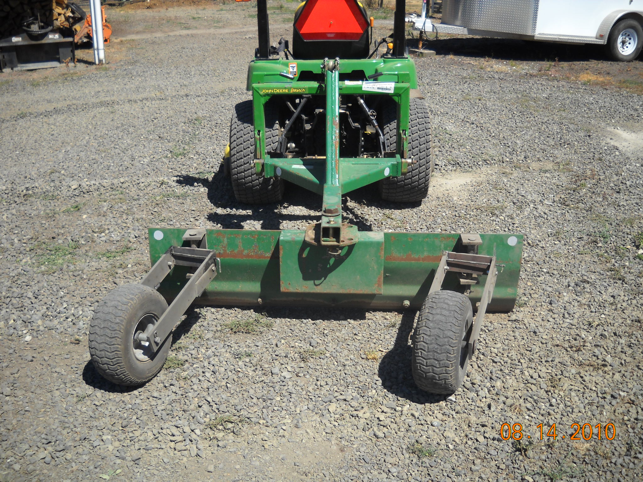

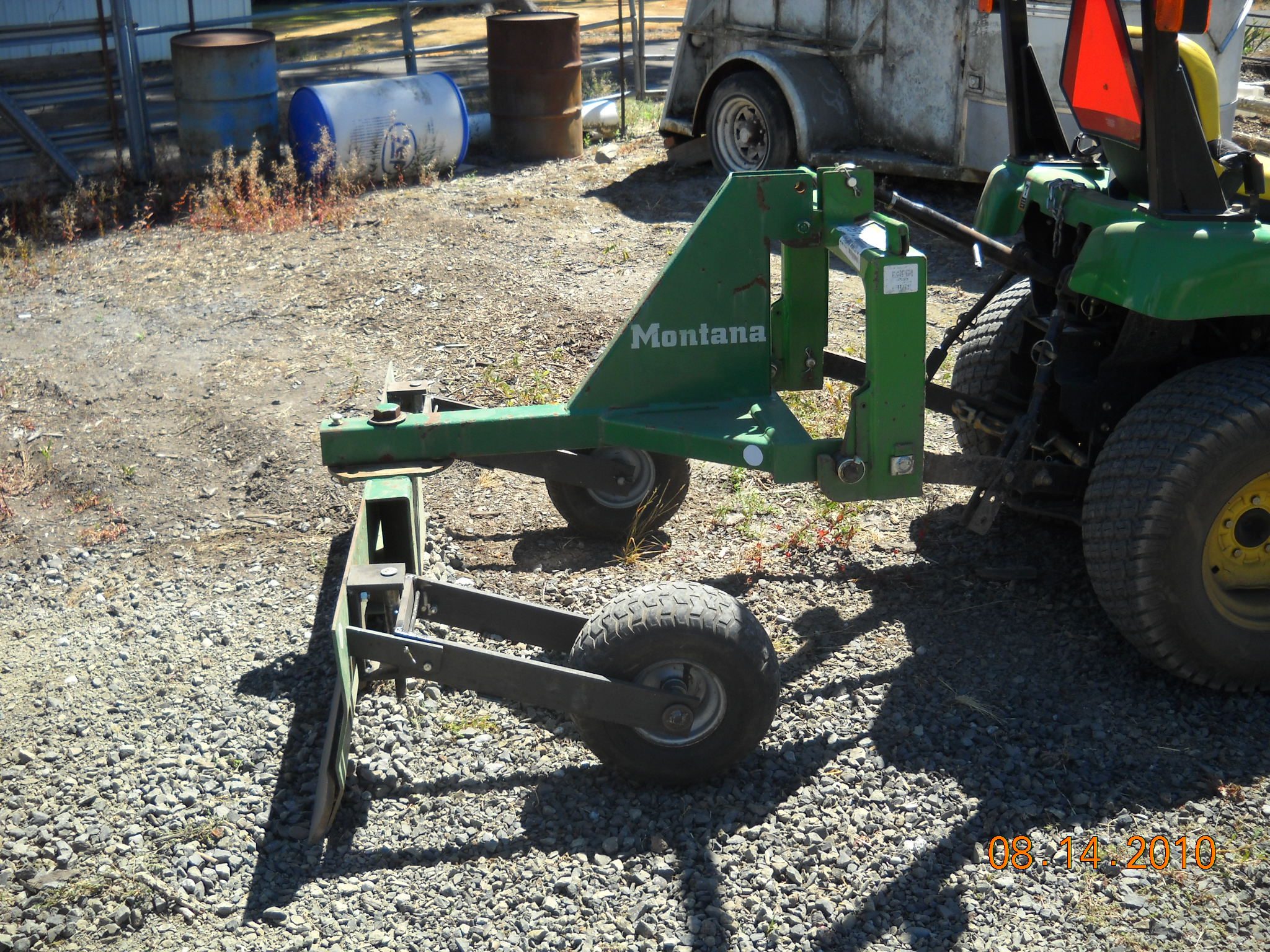

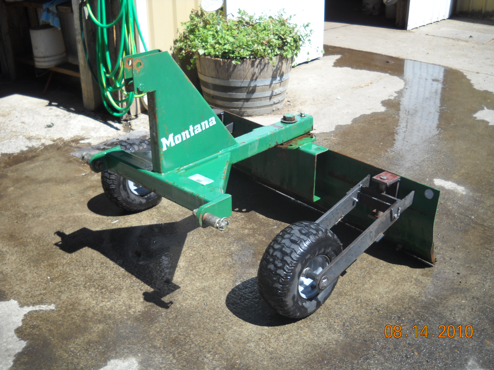

   / GC2400 rear blade #14
I have a 5' Montana blade that I got for $250 on sale. :thumbsup::D I have run it on several different tractors, SCUTs and CUTs from 19hp to 44hp and it has not let me down. One thing i did to it was add the rear gauge wheels which was one of the best things i have done to it. They can both pivot and be set at a stationary setting which holds them straight for use in reverse or to keep them from moving when running through the barns with the tractor. Also, having the wheels and reversing the blade allows it to be easy to unhook, a definite plus since I have 3 imatch systems. The gauge wheels allow you to have more control with digging depth so you can plow snow without scraping up the gravel driveway. It also allows you put put weights on the back for both digging and for ballast with FELs. I have nothing bad to say about the gauge wheels, all it takes is two lawn mower tires, about $25 in steel, and some time. :thumbsup: For my 19 hp Yanmar CUT, the 5 foot blade is just right, same for the JD SCUT and so on. :)

   / GC2400 rear blade #15
Cool idea:thumbsup:
