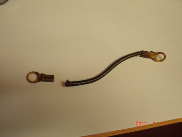

In general, a "clicking" noise is the starter relay clicking in & out due to insufficient amperage (or voltage). Sounds like the key switch is working, but it's not getting sufficient power to keep the really and starter engaged.
That can be caused by a number of things. Sounds like you may have eliminated the battery, so that leaves the circuitry going to the starter or, as you mentioned, the starter itself and/or the relay.
One of the biggest culprits on 2310s is the ground strap; apparently they were a tad short in length on some of them, and natural vibrations from the engine would gradually crack the strands in the ground cable one by one. Eventually, the tractor wouldn't start, though all other electricals might work. That starter (any starter) requires a bunch of amps during starting; any weakness in the circuit and you have problems.
Yes, it could be the starter, but I'd check that ground cable first. It's on the lower left front of the tractor, going from the frame near the hood hinge to the engine block, just under the oil filter. All of the starter amperage must pass through that cable. It will TRY to go through other points if that cable is weak, but the other wires are not heavy enough to carry the load.
On my tractor, it was becoming more & more sluggish in starting, and I thought I needed a new battery. Eventually, however, the last strand in that ground cable broke and left me high & dry. Thanks to others' suggestions on this forum, I checked it out and sure enough, it was separated at the point of flexing due to engine vibration. I eventually added a second ground cable to the other side of the engine, just for insurance.
Try to eliminate the easy stuff first.
