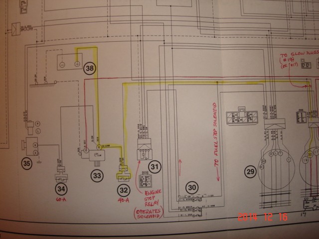

I reinstalled the starter and started it right up. I did notice I had positive voltage to the starter without the key being in the on position. I found that out when tightening the positive wires to the starter with a wrench that touched the engine block and it sparked. Is it normal to have 12v at the starter with the key in the off position?
   / GC2310 Won't even turn over #12
"Is it normal to have 12v at the starter with the key in the off position?"
Yes. You can see in the wiring diagram, the battery (#38) positive terminal and the wire that goes directly to the starter. The rest of highlighted yellow traces the path through the fuse to the ignition switch. Red is the feed from the switch to the starter relay.
When the key is turned to "START," the relay (on the left end of the starter motor, #33) is energized and makes the connection to ground. I believe that dashed line represents the ground cable I mentioned earlier.
