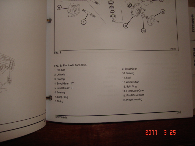

Gone Fishin'- here's a couple of pics from the service manual, might help out a bit. I figure I'll get to do this job sooner or later, too!
The manual really doesn't go into a lot of detail on the seals there, but Larry's description should cover it. Let us know how it goes, and if you could post some pics that would be great!

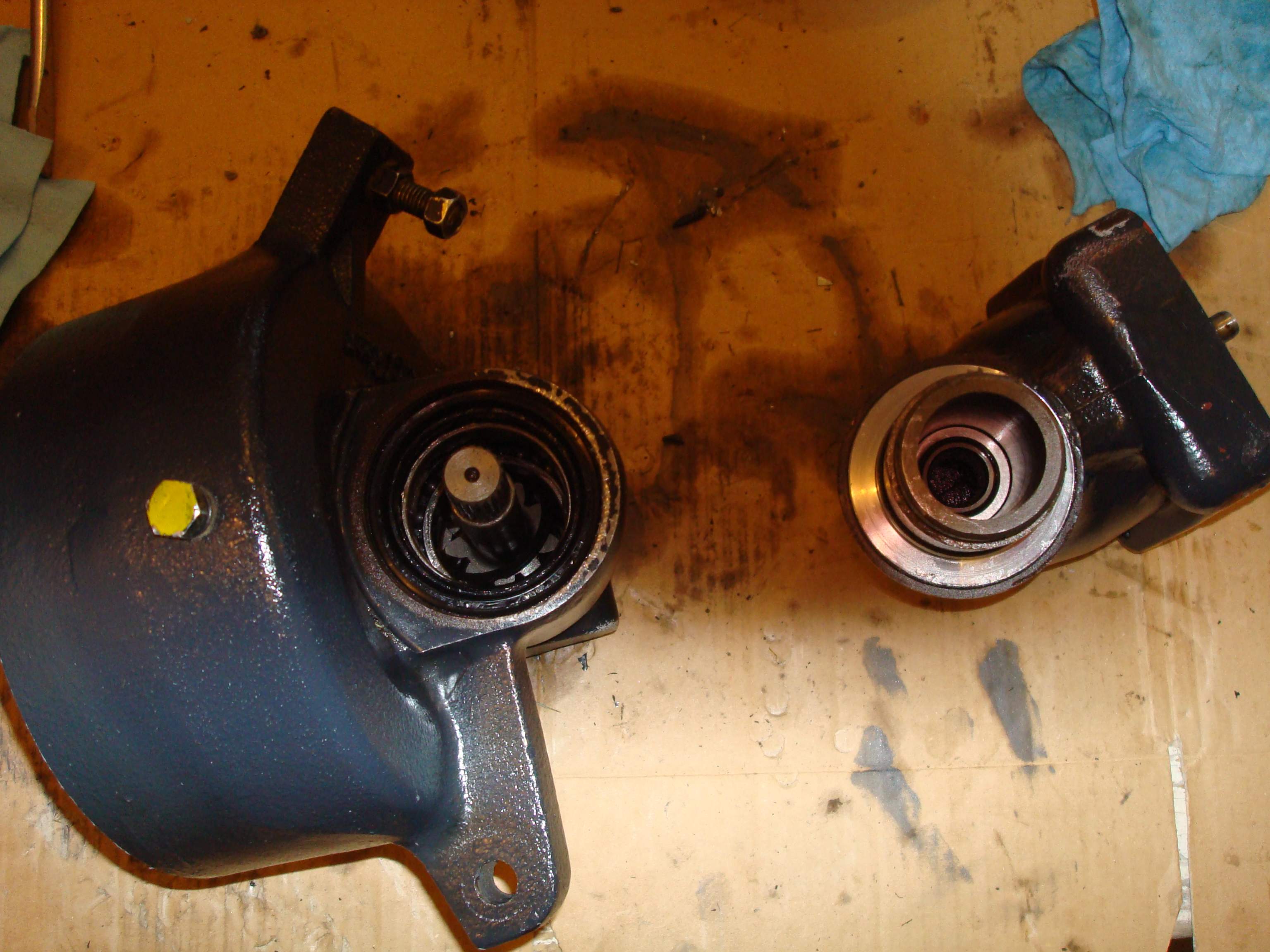

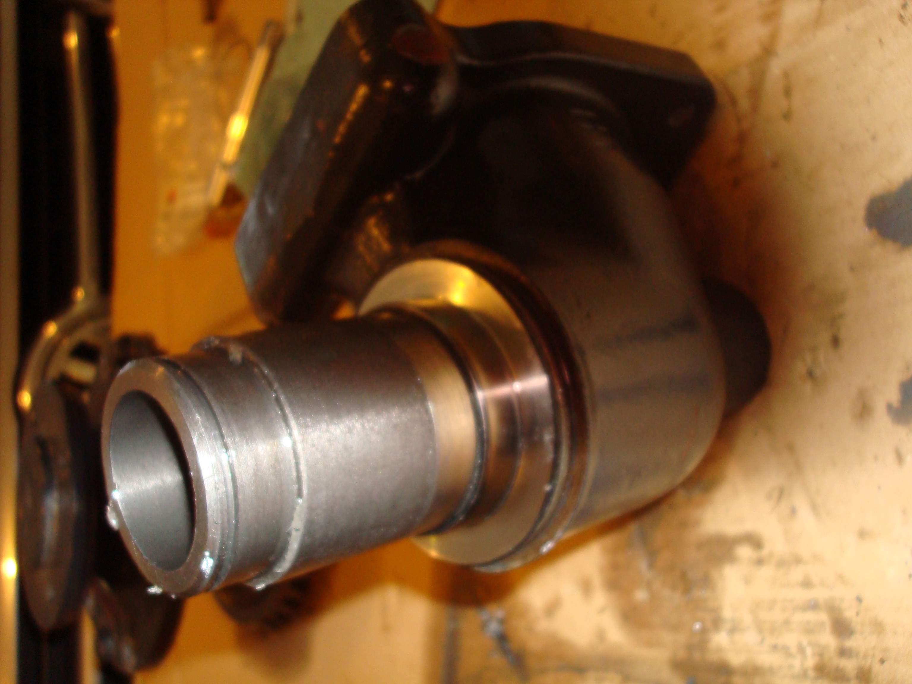

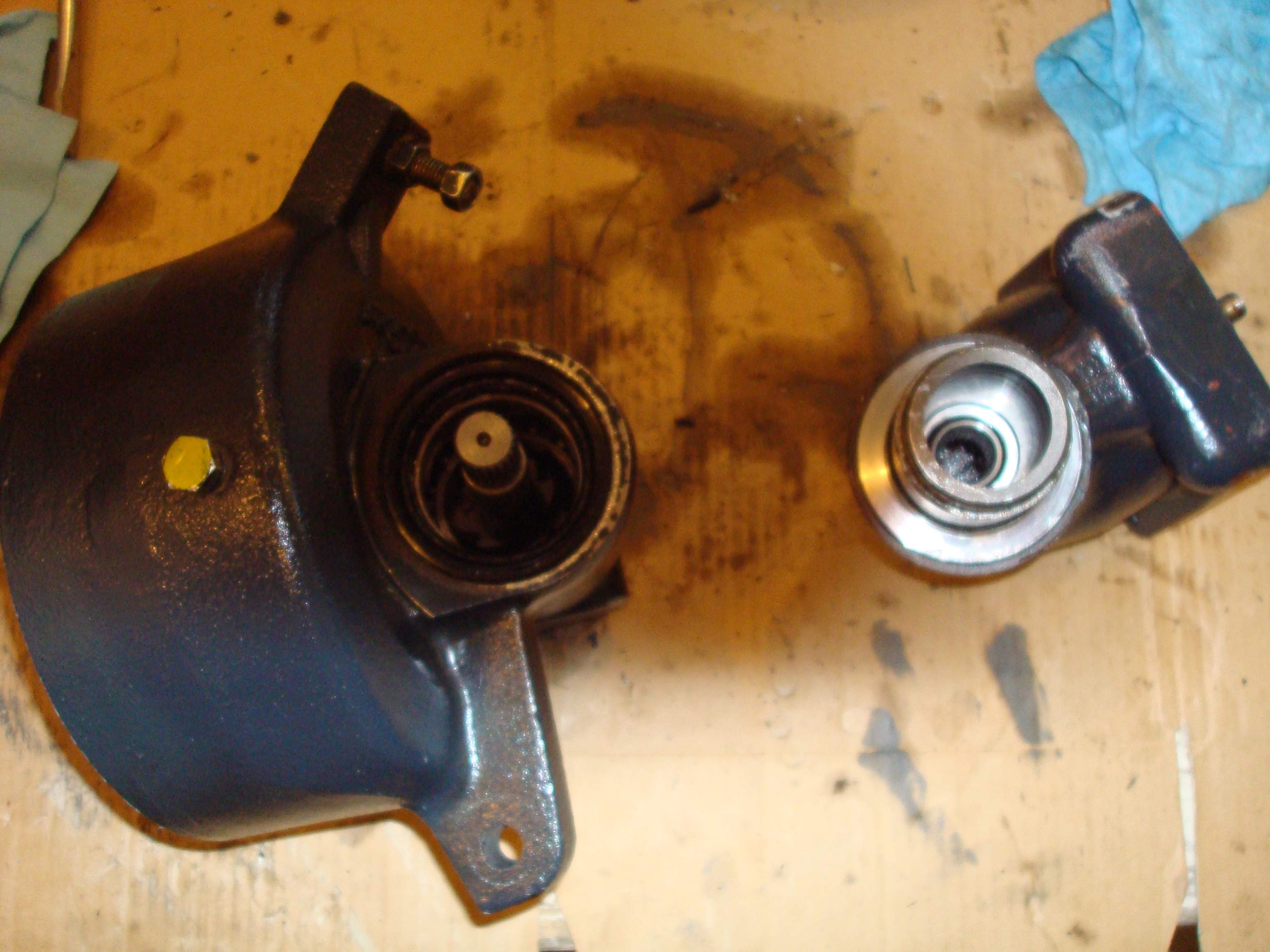

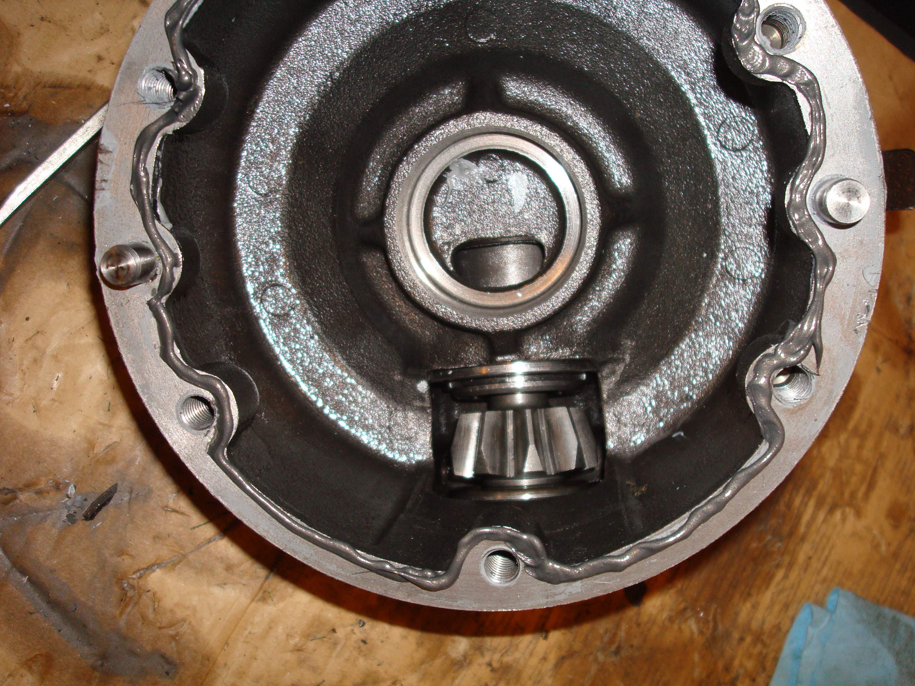

Ok - so I finally got my act together and took on this project in June. Although I'm fairly good with my hands, I don't have a lot of mechanical experience. As a result, this job took me the better part of two days. Larry's description was pretty much bang on. As he noted, the snap ring (3rd image) is a bear to remove -- spreaders with a fairly large spread are an absolute must. The old seal in the hub (2nd last image, left) required heat for removal, while the one on the shaft (last image, shiny disc at the base of the shaft) required lubrication of the shaft itself. I found that replacing the new seal on the shaft was best accomplished by pushing it on as far as possible, reassembling the hub and elbow, and then using a rubber mallet to knock the elbow back into the hub. In this way, I was able to force the seal into position using fairly even distribution of pressure.
