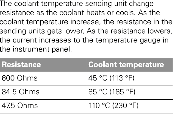

To check the sender is in spec:
/ GC1715 Temp Gauges Failure
Well I ran out there on lunch, I hooked up my power supply and connected the -ve to the battery ground and positive to the wire which I removed from the Thermostat. Dialed it up or 5v with the tractor in "on" and there was no response on the gauge.
Tested the thermostat terminal to the thermostat housing and got 400 Ohms.
Tested the Gauge end of the wire to the thermostat housing and got 400 Ohms.
Kenmbz is that chart for this particular tractor?

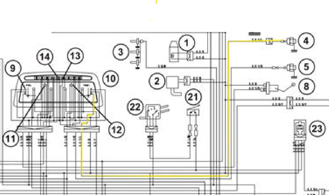

Wiring diagram shows a wire running straight form the gauge to the sending unit., I've checked out all the fuses as well and they test ok.

It was for a GC1723 I think. Should be close to ours.

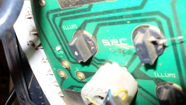

Had a temperature gauge failure on my NEW GC 1715 tractor on arrival..... Found out the 3 screws that attach the printed circuit board to back of temp gauge were loose.... Check the screws for snugness....

The GC 1715 does not have a computer.....
Its a simple circuit that puts a "resistive ground" out from "water temperature sensor" (term used on wiring diagram) back to "U" terminal on a analog gauge at instrument panel and through gauge to +12 volts... For all practical purposes temp gauge is nothing more than a "voltmeter" in concept.....

You're getting a lot of good suggestions. If you can access the circuit board check the solder connections. You are looking for cold solder joints and cracked or broken traces.
I had a similar issue with my GC1705 gauge ceasing to work after many years. Screws were not fully snug but also not loose, per se. I removed, wire brushed screw and contact, and replaced/snugged (one-by one) and it works now. Thanks for the info.
